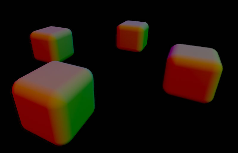

CUDAMeshDynamic#
Vertices of a shared dynamic mesh are processed on GPU using CUDA.
To build the sample, use CUDA Toolkit v12.4.
On Linux: after installing the CUDA Toolkit, make sure that the PATH environment variable includes /usr/local/cuda-12.2/bin.
SDK Path: <SDK_INSTALLATION>source\samples\3rdparty\CUDAMeshDynamic

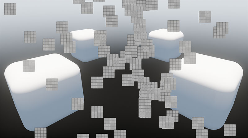

CUDAStructuredBufferWrite#
Particles in a shared structured buffer are updated on GPU using CUDA, and rasterized manually using Unigine Material with Compute Shader.
SDK Path: <SDK_INSTALLATION>source\samples\3rdparty\StructuredBufferWrite

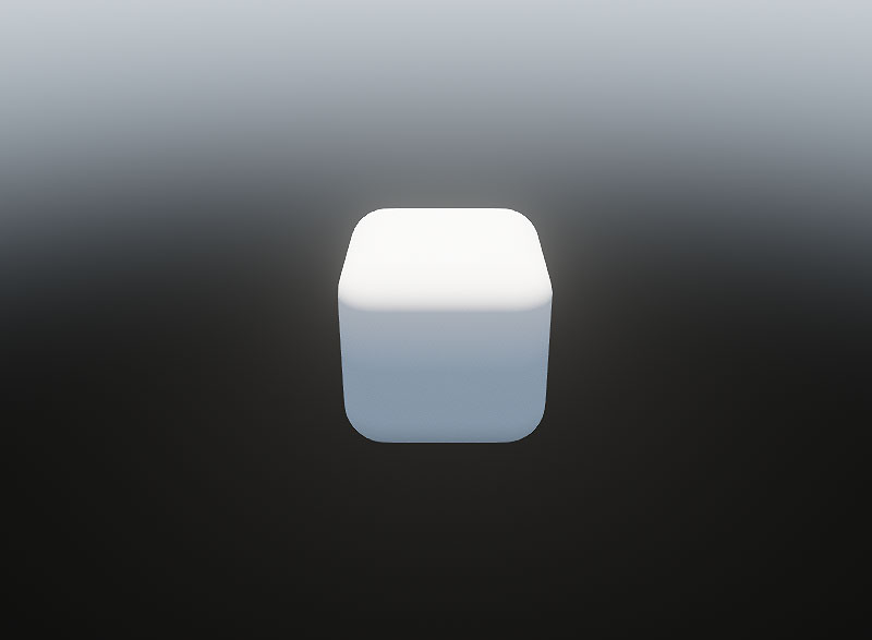

CUDATextureTransfer#
A shared texture is processed with CUDA and copied from video memory to RAM into Unigine Image.
SDK Path: <SDK_INSTALLATION>source\samples\3rdparty\CUDATextureTransfer

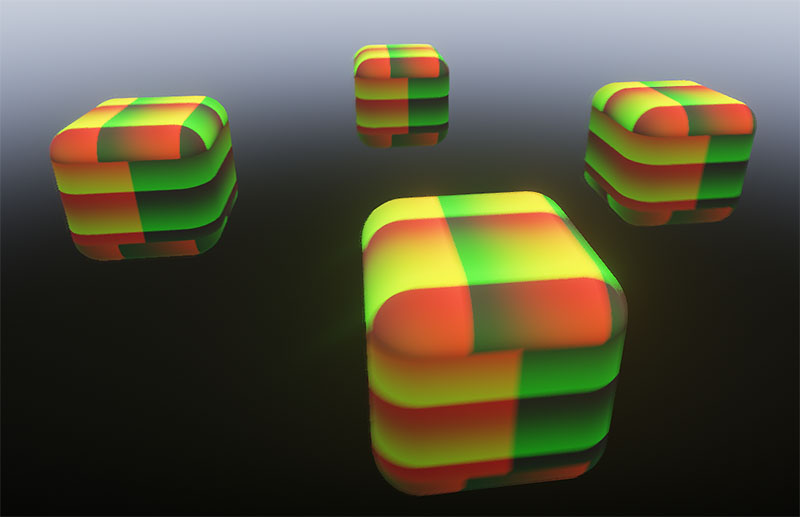

CUDATextureWrite#
A shared texture is processed with CUDA and displayed on the Unigine Object as a texture on a cube.
SDK Path: <SDK_INSTALLATION>source\samples\3rdparty\CUDATextureWrite
