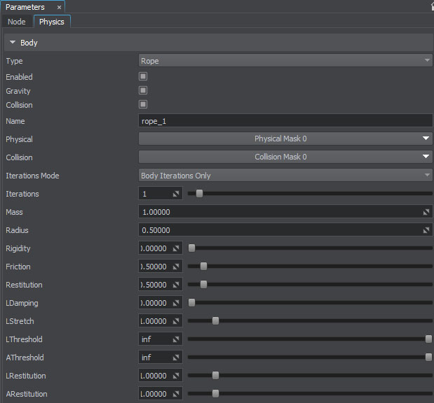

Assigning a Rope Body#
To assign a Rope body to an object via UnigineEditor perform the following steps:
  1. Open the World Hierarchy window.
  2. Select a dynamic mesh object to assign a Rope body to.
    Make sure that the object's mesh meets requirements!
  3. Go to the Physics tab in the Parameters window and assign a physical body to the selected object by selecting Body -> Rope.
    Adding a body
  4. Set the body's name and change other parameters, if necessary.
