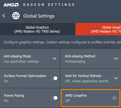

  1. Open AMD Radeon Settings (right mouse click on Windows desktop):
  2. Select Gaming section:
  3. Open Global Settings
  4. Enable checkbox named AMD CrossFire and click Confirm.
    You may have to switch to the different GPU if you don’t see this checkbox by default.

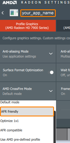

  5. After a screen flash, open Gaming section again. Select Add -> Browse at the top right corner and browse for your application executable (*.exe).
  6. After adding your application click on it to view additional settings and change AMD CrossFire Mode option to AFR Friendly

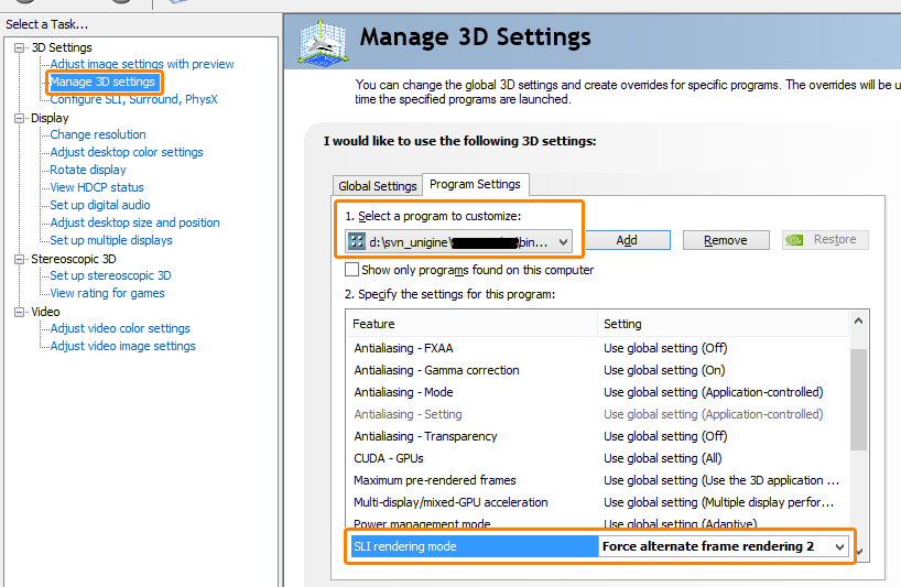

Follow these steps to enable AFR for your UNIGINE application.
  1. Open nVidia Control Panel (right mouse click on Windows desktop):
  2. Select Configure SLI, Surround, PhysX in the left menu;
  3. Enable SLI (select Maximize 3D Performance and click Apply):
  4. Select Manage 3D Settings
  5. On Program Settings tab click Add next to Select a program to customize
  6. In the Add window, that opens, click Browse
  7. Via the file dialog select your application and click Open.
  8. In the Settings column change SLI Rendering mode to Force alternate frame rendering 2
