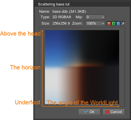

A texture defining the base color of the sky. The texture means the following:
  • Left to right: the position of the sun above the surface (time of day).
  • Top to down: the gradient of the sun.
At the example below, when sun's angle is 90 degrees (right in the middle of gradient), the sky's top is blue, the horizon is yellow, the sky below the horizon is brown.
Base LUT Texture

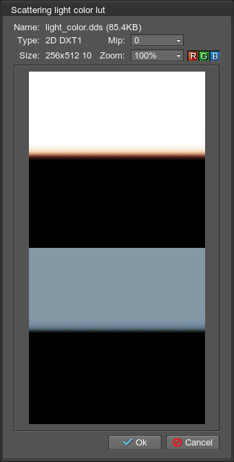

A texture defining the color of the LightWorld for different times of day. The texture means the following:
  • Top to down: the WorldLight's angle of slope.
Left to right texture direction doesn't matter, so you can use the texture 1×512 (width to height) pixels in size.
Light Color LUT Texture
