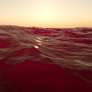

High-Level Systems
water_global_base
A water_base material simulates water and other liquids.
The water_global_base material performs quad tessellation of the water surface. But you should take into account that not the whole water surface is tessellated. In fact, we have two part of the water: inner that is tessellated (always under the camera) and outer that is not. Different parameters allows you to specify the distance of tessellated grid under the camera and the rate of decrementing the tessellation factor.
