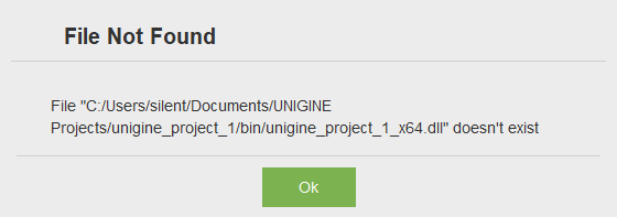

If you don't have .NET SDK installed, you can come across various errors while working with the project in both SDK Browser and UnigineEditor. For example, when running the application (clicking the RUN button) after creating it in SDK Browser, you may receive the error stating that File Not Found — File *_x64.dll doesn't exist:

To fix any possible errors with missing .NET SDK, you need to download and install .NET SDK using the following link: https://dotnet.microsoft.com/en-us/download/dotnet/8.0.
After installing .NET SDK, restart UnigineEditor to have all the changes in the OS be implemented correctly. For Windows, it is also recommended to restart the PC to have the %PATH% variable updated.

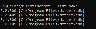

  1. Open the Command Prompt (Click the Start button and type cmd).
  2. In the window that opens, type the following:
    Shell commands
    dotnet --list-sdks
The following information should appear:
List of the SDKs installed on the PC

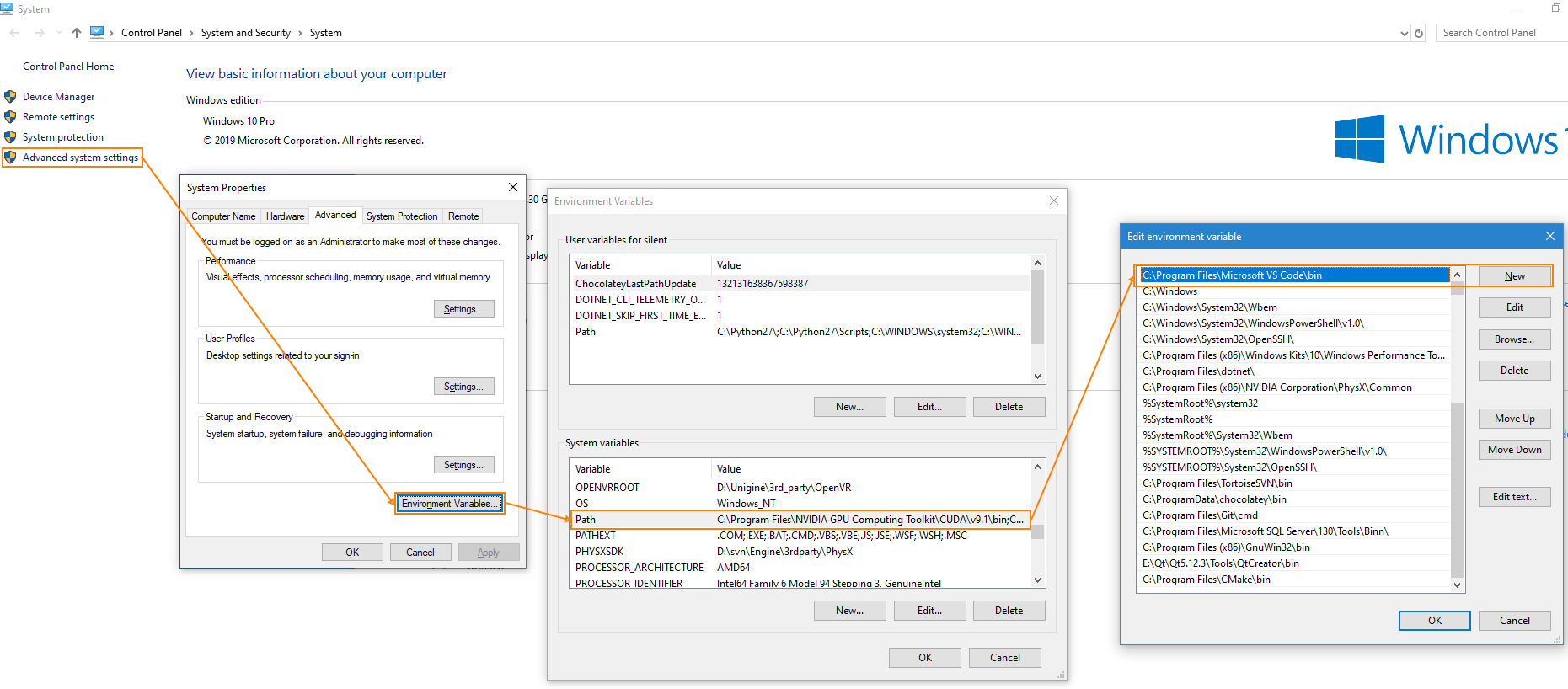

In case IntelliSense cannot be started due to the spawn cmd ENOENT error in the OmniSharp extension, it is recommended to add %WINDIR%\System32 to the PATH variable.
Editing the PATH variable on Windows 10

In case a single source file of a C# component is opened in VS Code when double-clicking it in UnigineEditor, it is recommended to make sure the path to the VS Code bin (%VSCODE_INSTALLATION_FOLDER%\bin) folder is added to the %PATH% environment variable, for example, as follows: C:\Program Files\Microsoft VS Code\bin.
