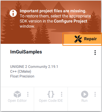

  4. Repair the project.
    • After importing, you'll see a Repair warning - this is expected, as only essential files are stored in the Git repository. SDK Browser will restore the rest.
    • Click Repair to let SDK Browser restore the required files.
    • When the configuration window opens, click Configure Project.
