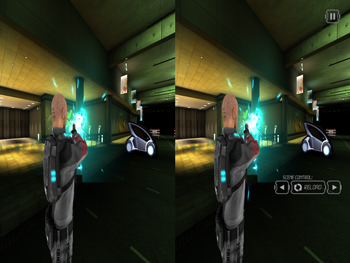

Separate Images#
This mode serves to output two separate images for each of the eye. It can be used with any VR/AR output devices that support separate images output, e.g. for 3D video glasses or helmets (HMD). See further details on rendering below.
To launch Separate images stereo mode, load the Separate plugin.

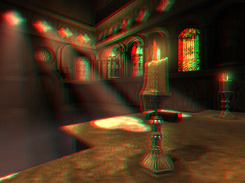

Anaglyph Mode#
Anaglyph stereo is viewed with red-cyan anaglyph glasses. See further details on rendering below.
To launch Anaglyph stereo mode:
  1. Specify the STEREO_ANAGLYPH definition on the start-up (together with other required CLI arguments).
  2. Run the 64-bit application (or its debugging version).
Shell commands
main_x64 -extern_define STEREO_ANAGLYPH

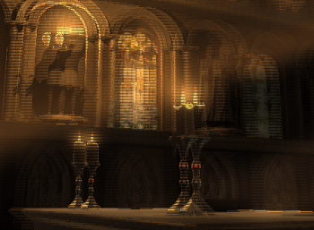

Interlaced Lines#
Interlaced stereo mode is used with interlaced stereo monitors and polarized 3D glasses. See further details on rendering below.
In this mode, the vertical resolution of the image is dropped in half.
To launch the interlaced lines stereo mode:
  1. Specify the STEREO_INTERLACED definition on the start-up (together with other required CLI arguments).
Shell commands
main_x64 -extern_define STEREO_INTERLACED
Interlaced lines stereo mode

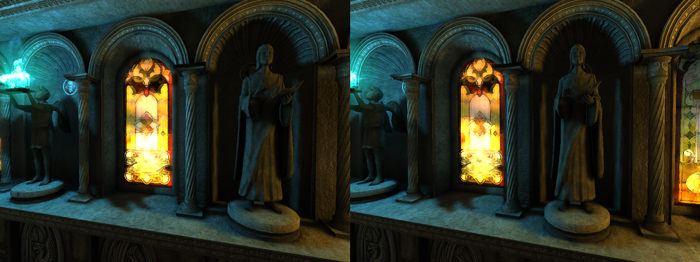

Horizontal stereo mode

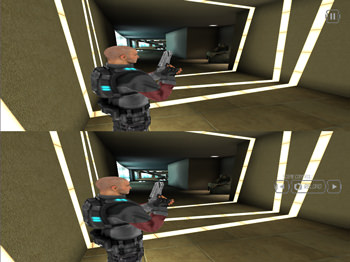

To launch Vertical stereo mode:
  1. Specify the STEREO_VERTICAL definition on the start-up (together with other required CLI arguments).
Shell commands
main_x64 -extern_define STEREO_VERTICAL
