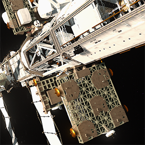

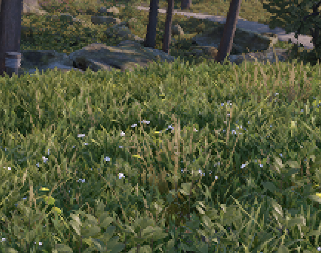

ISS without TAA.

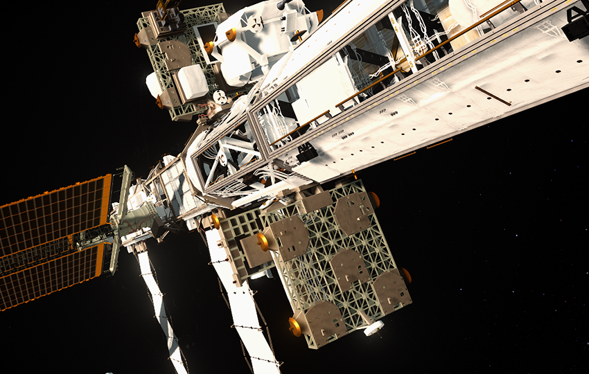

ISS with TAA.

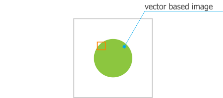

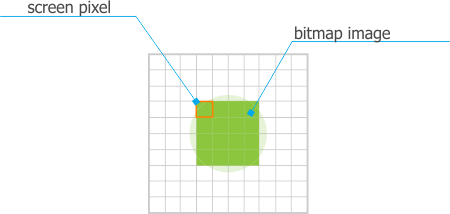

During rasterization process, there is a test whether the object will get into pixel or not. And the object will not be rendered if it doesn't occupy a major part of a pixel.
Vector image before rasterization.
And here we can get an error, when we have a sphere object before rasterization and get a square object after, because some parts of the sphere don't occupy enough pixel space.
Bitmap image after rasterization without TAA.

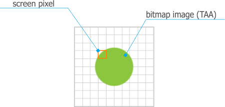

Bitmap image after rasterization with TAA.

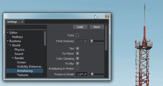

Temporal Anti-Aliasing (TAA) settings are available for adjustment via the Render -> Antialiasing section of the Settings window, along with SRAA, Fast approXimate Anti-Aliasing (FXAA) and Supersampling settings. The following settings are available when the Custom preset for Anti-Aliasing is selected.
TAA Settings
Anti-Aliasing Settings

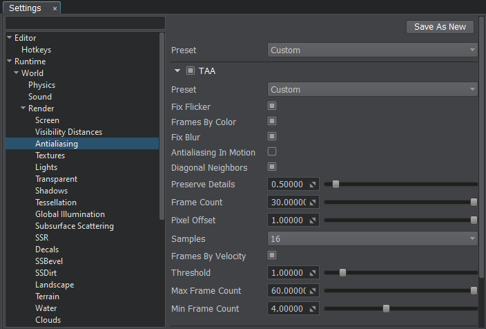

TAA custom settings
TAA Settings
Fix Flicker The value indicating if the taa fix flicker option is enabled. This option fixes flickering edges caused by TAA: it removes bright pixels by using the pixel brightness information from the previous frame. It is recommended to enable the option for bright thin ropes, wires and lines. The option is available only when TAA (see the TAA) is enabled.
Enabling this option may increase performance costs.
enabled by default.
Console access: render_taa_fix_flicker (API control)
Frames By Color The value indicating if TAA color clamping option is enabled. This option clamps the color of the current and previous frame. The image becomes more sharp. TAA (see the TAA) must be enabled. enabled by default.

Below is an example of TAA settings for relatively static scenes.
TAA Settings for Relatively Static Scenes
Recommended Antialiasing Settings for Relatively Static Scenes
  • The Diagonal Neighbors option should be enabled, as it provides more accurate pixel color information reducing the stair-step effect. At the same time TAA causes more blurring is case of fast camera movement, which is especially noticeable on grass and other similar high-contrast screen areas.
  • Preserve Detail value is decreased to reduce flickering of small pixels.
  • The number of TAA Samples is set to 16, which increases the number of variants for subpixel camera jittering, thus making the stair-step effect even less noticeable.
