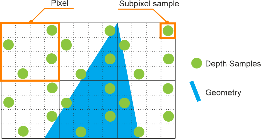

SRAA is used in deferred rendering to achieve high-quality anti-aliasing by sampling geometry at higher resolution than shading, since shading usually changes more slowly than geometry.
There are two stages in SRAA:
  1. Depth prepass multisampling generates depth position information at subpixel resolution. Subpixels are subdivision cells of a pixel. Depth prepass samples the geometry in the screen-space and stores samples’ position information in a G-buffer.

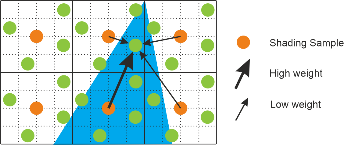

  2. Reconstruction pass uses the custom filter after the deferred shading to refine the shading results and output a screen-resolution, antialiased frame. In the picture below you can see how the SRAA reconstructs one subpixel.
    At each geometric sample, all shaded neighbors in a fixed radius are considered and their values are interpolated using our custom filter with weights to restore subpixel details. A neighboring sample with significantly different depth is considered to be across a geometric edge (blue line), and receives a low weight. The filter weights estimate distance between source and target samples by comparing their depth values.

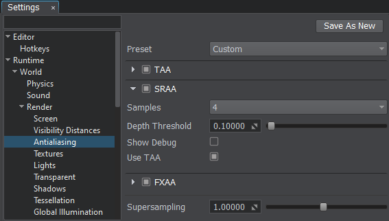

SRAA Adjustment#
Subpixel Reconstruction Anti-Aliasing (SRAA) settings are available for adjustment via the Render -> Antialiasing section of the Settings window, along with Fast approXimate Anti-Aliasing (FXAA), Temporal Anti-Aliasing (TAA) and Supersampling settings. The following settings are available when the Custom preset for Anti-Aliasing is selected.
SRAA Settings
Anti-Aliasing Settings
SRAA Settings#
SRAA The value indicating if Subpixel Reconstruction Anti-Aliasing (SRAA) is enabled. disabled by default.
Console access: render_sraa (API control)
Samples The number of depth geometry samples per pixel. This value may significantly affect performance, so keep it low when the image quality differences are not apparent. One of the following values:
  • 2
  • 4 (by default)
  • 8
Console access: render_sraa_samples (API control)

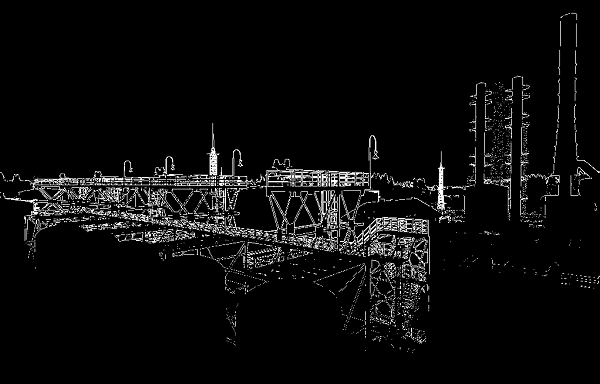

Depth Threshold The depth threshold value used for edges detection that specifies the area for the SRAA processing. Turn on the debug mode and adjust this parameter in such a way that covers the required edges but at the same time leaves out the unnecessary geometry in the scene.
Range of values: [0.0f, inf]. The default value is : 0.1f.
Console access: render_sraa_depth_threshold (API control)
Show Debug The value indicating if the SRAA debug mode is enabled. This mode shows the geometry edges smoothed by the SRAA. disabled by default.
Console access: render_sraa_debug (API control)
Use TAA The value indicating if TAA integration is enabled. SRAA will use the shading sample from the previously rendered frame (TAA) to achieve correct anti-aliasing. Uses camera jittering, so it works only when the TAA (see the TAA) is enabled. It is recommended to use this option by default. enabled by default.
Console access: render_sraa_temporal (API control)
