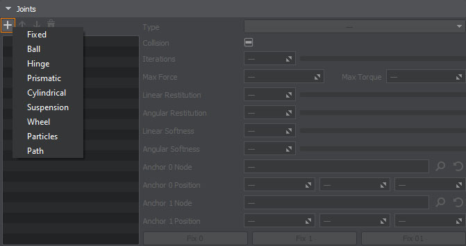

Adding a Joint#
Assume you have two objects with physical bodies assigned. Remember that a body must have a shape assigned. To connect them using a joint via UnigineEditor, perform the following steps:
  1. Open the World Hierarchy window.
  2. Select the first body to connect.
  3. Go to the Physics tab in the Parameters window.
  4. In the Joints section, click and choose an appropriate type of joint.
    Adding a joint

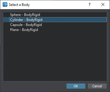

  5. Select the second body by picking its name in the dialog window and click OK.
    Selecting a body
  6. Set joint parameters in the Joints section.
You can enable visualization of the joint by checking Helpers panel → Physics item → Joints option (Visualizer should be enabled).

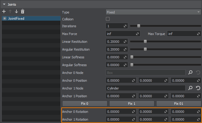

In addition to the common parameters, fixed joints also have the following constraint parameters:
Fixed Joint Parameters
Anchor 0 Rotation Orientation of the first body relative to the anchor point.
Anchor 1 Rotation Orientation of the second body relative to the anchor point.
For more information refer to JointFixed Class description. An example illustrating connection of two bodies using a fixed joint can be found here.

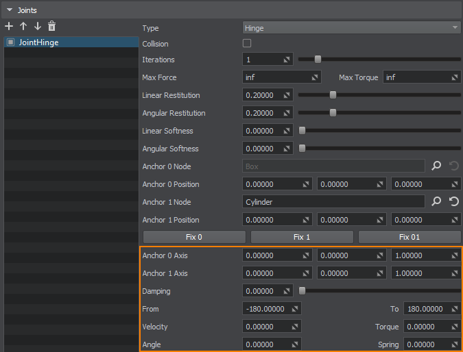

In addition to the common parameters, hinge joints also have the following constraint parameters:
Hinge Joint Parameters
Anchor 0 Axis Axis of the first connected body represented by a normalized vector.
Anchor 1 Axis Axis of the second connected body represented by a normalized vector.
Damping Angular damping coefficient of the hinge joint.
From Minimum angle in the range of movement at which the hinge stops. The angle is specified in degrees in the [-180; 180] range.
To Maximum angle in the range of movement at which the hinge stops. The angle is specified in degrees in the [-180; 180] range.
Velocity Target velocity of the attached angular motor.
Torque Maximum torque of the angular motor. 0 detaches the motor.
Angle Target angle of the attached angular spring. The spring (if it is enabled) tries to keep the specified angle between the connected bodies.
Spring Spring rigidity coefficient, determines how strong the joint resists rotation. If rigidity is set to 0, the spring is disabled.
For more information refer to JointHinge Class description. An example illustrating connection of two bodies using a hinge joint can be found here.

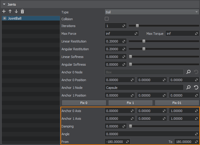

Ball Joint#
Ball joints provide a point around which the connected objects can rotate.
Ball joint Ball joint
Ball Joint
In addition to the common parameters, ball joints also have the following constraint parameters:
Ball Joint Parameters
Damping Angular damping coefficient of the ball joint.
Angle Swing angle limit, specifies how much connected bodies can bend from the joint axis.
From Minimum angle in the range of twisting around the joint axis. The angle is specified in degrees in the [-180; 180] range.
To Maximum angle in the range of twisting around the joint axis. The angle is specified in degrees in the [-180; 180] range.
For more information refer to JointBall Class description. An example illustrating connection of two bodies using a ball joint can be found here.

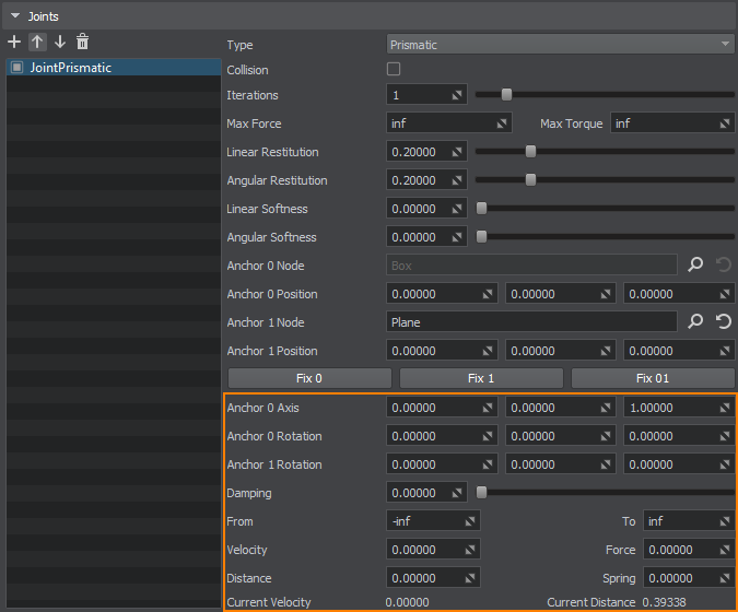

Prismatic Joint#
Prismatic joints allow movement along the joint axis. This joint has a linear motor attached.
Prismatic joint Prismatic joint
Prismatic Joint
In addition to the common parameters, prismatic joints also have the following constraint parameters:
Prismatic Joint Parameters
Damping Linear damping coefficient of the prismatic joint.
From Minimum distance between the bodies along the joint axis.
To Maximum distance between the bodies along the joint axis.
Velocity Target velocity of the attached linear motor.
Force Maximum force of the attached linear motor. 0 detaches the motor.
Distance Target linear distance of the attached spring. The spring (if it is enabled) tries to keep the specified distance between the connected bodies.
Spring Spring rigidity coefficient, determines how strong the joint resists linear motion. If rigidity is set to 0, the spring is disabled.
For more information refer to JointPrismatic Class description. An example illustrating connection of two bodies using a prismatic joint can be found here.
Watch the illustration of the Prismatic joint in our video tutorial on physics.

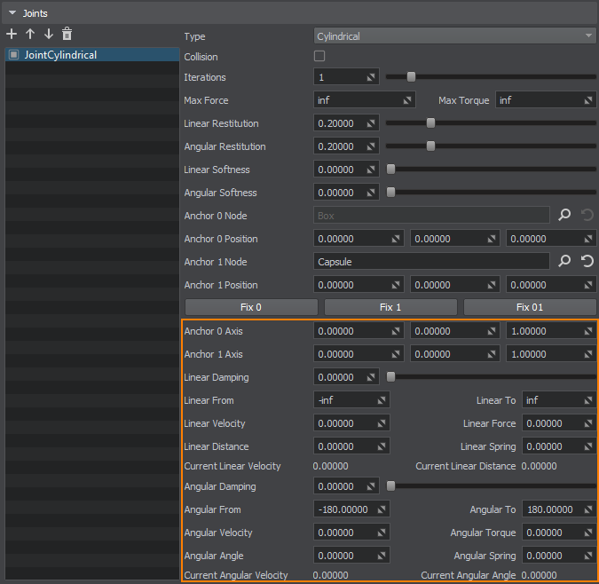

Cylindrical Joint#
Cylindrical joints are like prismatic ones with an additional degree of freedom: rotation around the joint axis. This joint has a linear and an angular motors attached.
Cylindrical joint Cylindrical joint
Cylindrical Joint
In addition to the common parameters, cylindrical joints also have the following constraint parameters:
Cylindrical Joint Parameters
Linear Damping Linear damping coefficient of the cylindrical joint.
Linear From The minimum distance between the bodies along the joint axis.
Linear To The maximum distance between the bodies along the joint axis.
Linear Velocity Target velocity of the attached linear motor.
Linear Force Maximum force of the attached linear motor. 0 detaches the motor.
Linear Distance A target linear distance of the attached spring. The spring (if it is enabled) tries to keep the specified distance between the connected bodies.
Linear Spring Spring rigidity coefficient, determines how strong the joint resists linear motion. If rigidity is set to 0, the spring is disabled.
Angular Damping Angular damping coefficient of the cylindrical joint.
Angular From The minimum angle in the range of twisting around the joint axis. The angle is specified in degrees in the [-180; 180] range.
Angular To The maximum angle in the range of twisting around the joint axis. The angle is specified in degrees in the [-180; 180] range.
Angular Velocity Target velocity of the attached angular motor.
Angular Torque Maximum torque of the angular motor. 0 detaches the motor.
Angular Angle A target angle of the attached angular spring. The spring (if it is enabled) tries to keep the specified angle between the connected bodies.
Angular Spring Spring rigidity coefficient, determines how strong the joint resists rotation. If rigidity is set to 0, the spring is disabled.
For more information refer to JointCylindrical Class description. An example illustrating connection of two bodies using a cylindrical joint can be found here.
Watch the illustration of the Cylindrical joint in our video tutorial on physics.

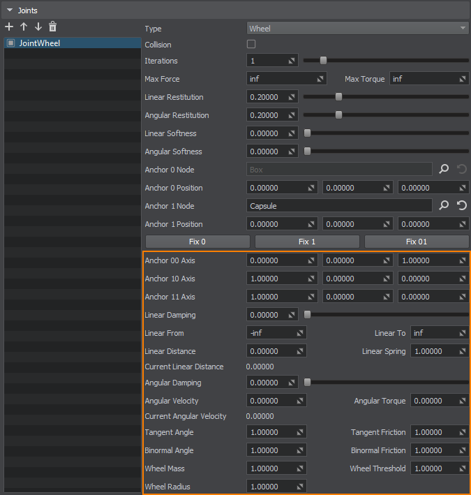

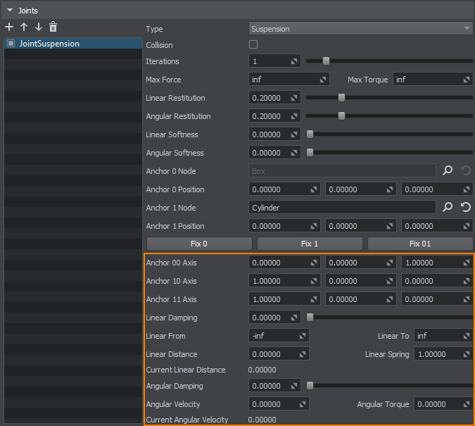

Wheel Joint#
Wheel joints are used to create ray-cast vehicle wheels. It connects two rigid bodies: the first body is a frame, the second one is a wheel. There is no need to assign a shape to the wheel: ray casting is used to detect collision of the wheel with a surface. This joint has an angular motor attached.
The order of the bodies connected using a wheel joint, matters!
  • If the bodies are connected using UnigineEditor:
    1. Select the vehicle frame.
    2. Add a wheel joint.
    3. Specify the wheel to be attached.
  • If the bodies are connected via code:
    • b0 is a frame.
    • b1 is a wheel.
Wheel joint Wheel joint
Wheel Joint
In addition to the common parameters, wheel joints also have the following constraint parameters:
Wheel Joint Parameters
Anchor 00 Axis Coordinates of a vertical axis (suspension axis) that acts like a cylindrical joint providing steering and damping.
Anchor 10 Axis Coordinates of a horizontal axis around which the wheel rotates, in the coordinate system of the frame (which is body 0).
Anchor 11 Axis Coordinates of a horizontal axis around which the wheel rotates, in the coordinate system of the wheel (which is body 1).
Linear Damping Linear damping coefficient of the suspension.
Linear From Lower suspension ride limit.
Linear To Upper suspension ride limit.
Linear Distance Target suspension height. The suspension spring (if it is enabled) tries to keep the specified height.
Linear Spring Suspension spring rigidity coefficient, determines how strong the joint resists vertical linear motion. If rigidity is set to 0, the spring is disabled.
Angular Damping Angular damping coefficient of wheel rotation.
Tangent Angle Coefficient specifying how fast the optimal longitudinal force can be achieved. The larger this value, the more is the impulse produced by the tire.
Tangent Friction Longitudinal (forward) friction of the tire.
Binormal Angle Coefficient specifying how fast the optimal lateral force can be achieved. The larger this value, the more is the impulse produced by the tire.
Binormal Friction Lateral (sideways) friction of the tire.
Wheel Mass Mass of the attached wheel.
Wheel Threshold Threshold difference between the wheel and ground velocities. When it is too small, the longitudinal force is scaled down to prevent unnatural vibrations.
Wheel Radius Radius of the attached wheel.
For more information refer to JointWheel Class description. For an example illustrating the use of wheel joints see the Creating a Car with Wheel Joints article.
Watch how to simulate a wheel using the Wheel joint in our video tutorial on physics.
Suspension Joint#
This joint type is deprecated and will be removed in the upcoming releases. It is recommended to use the Wheel Joint instead.
Suspension joints are used to create wheel suspension for vehicles. It connects two rigid bodies: the first body is a frame, the second one is a wheel. This joint has an angular motor attached.
The order of the bodies connected using a suspension joint, matters!
    2. Add a suspension joint.
    • b0 is a frame.
    • b1 is a wheel.
Suspension joint Suspension joint
Suspension Joint
In addition to the common parameters, suspension joints also have the following constraint parameters:
Suspension Joint Parameters
For more information refer to JointSuspension Class description. An example illustrating connection of two bodies using a suspension joint can be found here.
For the difference between the Suspension and Wheel joints, see our video tutorial on physics.

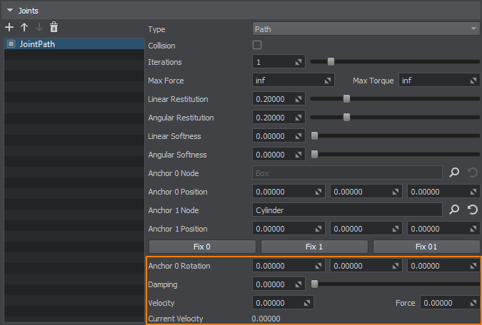

Path Joint#
Path joint is used to attach a rigid body to a path body and to make it move along this path. This joint can be used to make a train move along the tracks. This joint has a linear motor attached.
Assign a shape to a rigid body before connecting it to a path body!
The order of the bodies connected using a path joint, matters!
    1. Select a rigid body.
    2. Add a path joint.
    3. Specify the path body.
    • b0 is a BodyRigid.
    • b1 is a BodyPath.
Path joint
Path Joint
In addition to the common parameters, path joints also have the following constraint parameters:
Path Joint Parameters
Anchor 0 Rotation Orientation of the body relative to the path.
Damping Linear damping coefficient of the path joint.
For more information refer to JointPath Class description. An example illustrating connection of two bodies using a path joint can be found here.
Our video tutorial on physics shows how to attach a rigid body to a path body using the Path joint.

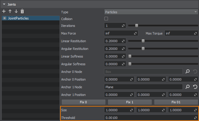

Particles Joint#
Particles joint is used to pin cloth body or rope body to a rigid body, ragdoll body or a dummy body.
The order of the bodies connected using a particles joint, matters!
    1. Select a rigid body, a ragdoll body or a dummy body.
    2. Add a particles joint.
    3. Specify a cloth body or a rope body.
    • b0 is a BodyRigid / BodyRagdoll / BodyDummy.
    • b1 is a BodyCloth / BodyRope.
Particles joint
Particles Joint
In addition to the common parameters, particles joints also have the following constraint parameters:
Particles Joint Parameters
Size Size of the area for pinning vertices of cloth or rope body to another body.
Threshold Distance for pinning vertices of cloth or rope body to another body. If vertices are closer than the threshold, they are pinned together; otherwise, particles stay loose.
For more information refer to JointParticles Class description. An example illustrating attachment of a cloth body using a particles joint can be found here.
An example illustrating the use of rope body and particles joint can be found here.
Our video tutorial on physics shows how to attach a rope or a cloth to other bodies using the Particles joint.
