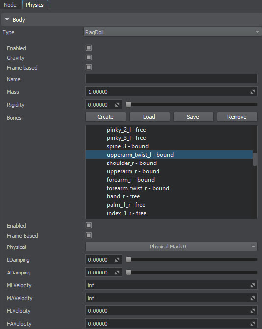

To assign a Ragdoll body to an object in UnigineEditor, perform the following steps:
  1. In the World Nodes window, select the Mesh Skinned object that you want to assign a Ragdoll body to.
  2. Switch to the Physics tab in the Parameters tab and select Body -> RagDoll.
    Adding a body
  3. Set the body name and proceed with creating a skeleton.

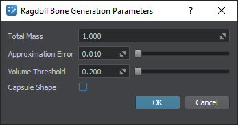

When the Ragdoll body is assigned to the Mesh Skinned object, all the bones are free, i.e. not united into a skeleton. Click the Create button to configure the Ragdoll bone generation parameters and automatically generate a skeleton.
To generate the skeleton properly, the mesh should be in the Reference Pose (T-pose for human-like characters). If animation has been already applied to the mesh, apply an animation with the static Reference Pose.
Automatic generation is performed on the basis of the following parameters:
Total Mass
Total mass of the Ragdoll will be automatically distributed among all the shapes that approximate bones. By distribution, the volume that the shape occupies is taken into account. If the mass is changed afterwards, masses of all the shapes are recalculated. And the opposite way, if shape mass is changed, the total mass is modified correspondingly.
Approximation Error
The value that makes it possible to control the number of vertices in the resulting shape. Depending on the use case, the shape may be more or less detailed.
  • Lower values ensure a more accurate and close to the mesh approximated shape.
  • The maximum value of 1 provides quite rough approximation that may not cover all the mesh volume.
Volume Threshold
When creating a Ragdoll, small bones (like finger bones, for example) are rarely simulated. They are too insignificant to change the motion of the whole object, as their mass and volume is not sufficient for that. Volume threshold allows to merge all small adjacent bones, the volume of which is too small, into one shape:
Value = 0 (minimum):
all the bones without exception are represented in rigid bodies and hence shapes.
Value = 1 (maximum):
approximation shapes are big and follow only the major bones. Small bones are included in this volume, but their individual transformations are not considered in physical simulation.
Minimum volume threshold    Maximum volume threshold
Volume threshold defines whether all bones up to the smallest one should be simulated separately or merged into bigger shapes

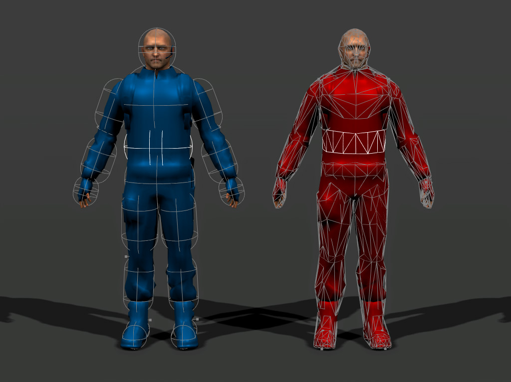

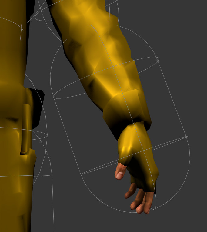

Capsule Shape
This setting defines the approximation shape to be used for bones:
  • If enabled, the Capsule shape is used — it provides very fast physics simulation and continuous collision detection.
  • If disabled, Convex hull is used — it ensures more accurate approximation.
If any other shape is required, approximation is to be done manually.

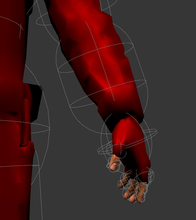

Approximation with capsules and convex hulls
Remember that physical shapes don't need to reproduce the mesh precisely. Rough approximation provides physical interaction that is realistic and convincing enough.

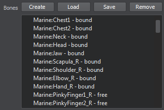

Body Hierarchy for Bones#
After the skeleton has been created, all the bones that participate in the physical body movement have rigid bodies and shapes and are marked as bound in the hierarchy. All the small bones not participating in physical body movement remain marked as free. If automatically generated shapes don't fit the object contours, they can be tuned manually till their approximation is satisfying enough.
The hierarchy of bodies and shapes that approximate bones may be saved into a *.node file and loaded from it. You can also remove the set hierarchy from the Ragdoll body and create it anew.
Hierarchy of rigid bodies that represent bones

Parameters#
In addition to the parameters available for the rigid bodies, the following parameters can be adjusted to configure the Ragdoll body:
Frame-Based
Toggles frame-based animation on and off. When disabled, bone transformations are conditioned by physics, instead of being based on skinned animation data.
This option is available for both the whole ragdoll body and individually selected bound bones.
Rigidity
Allows to additionally constrain the motion of the skeleton. This parameter determines how uniform the motion of Ragdoll parts is. To achieve that, both linear and angular velocities of each separate rigid body are corrected according to the total velocities interpolated from all the bodies.
  • By the minimum value of 0, all Ragdoll parts represented in rigid bodies move independently and unrestricted (of course, except for joint constrains). This gives an impression of loose and floppy movement.
  • By the maximum value of 1, Ragdoll parts move in a uniform and stiff manner, which may seem over-constrained.

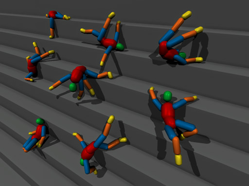

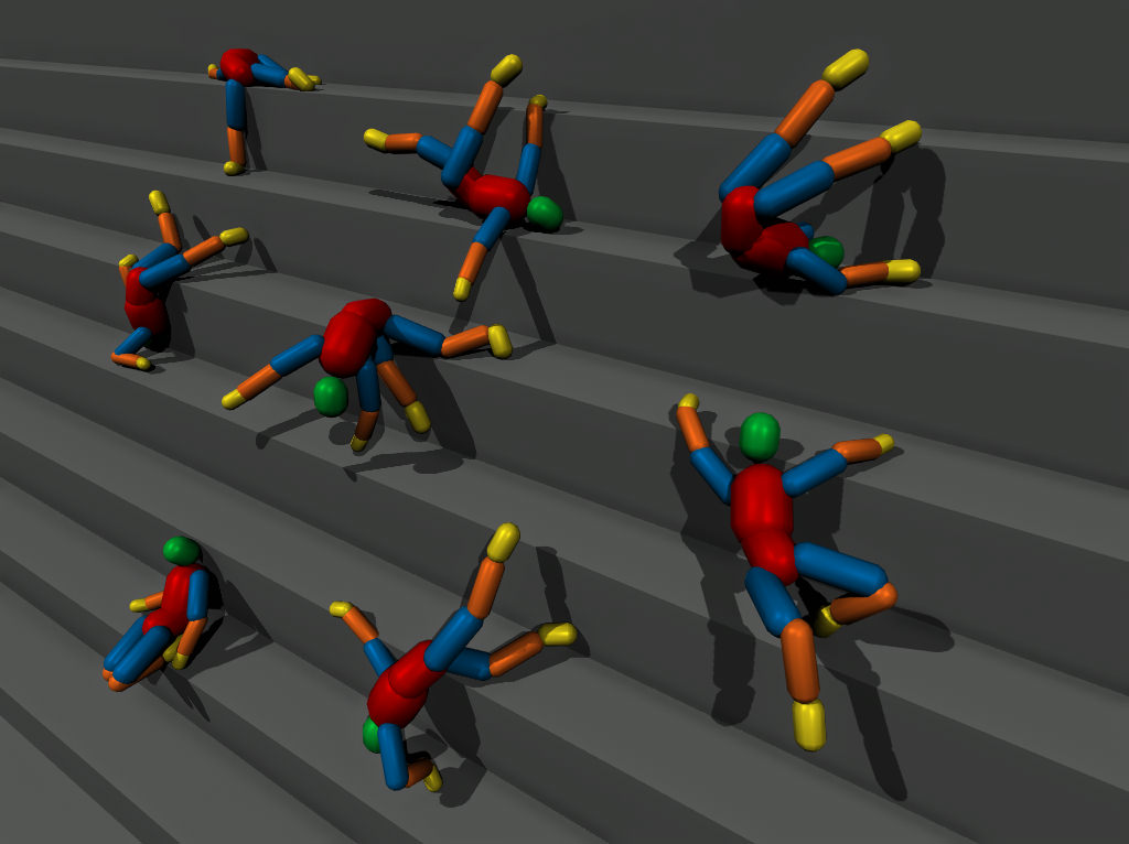

Enabling Ragdoll Animation#
When the character, for example, hits some obstacle or is shot and dies, it is necessary to turn off bone-based animation playback and simulate the character realistically falling according to the physical laws. When the Frame-based option is disabled, Ragdoll body is no longer driven by the bone transformations. It collapses according to Rigid body dynamics (masses of all rigid bodies, that represent parts of the skeleton, velocity damping, etc.), joint constraints and Rigidity of motion.
Enabling the Ragdoll animation affects only the bones that were physically approximated. For example, small bones that were discarded based on the volume threshold, will still move. To prevent this from happening, mesh animation should be stopped explicitly.

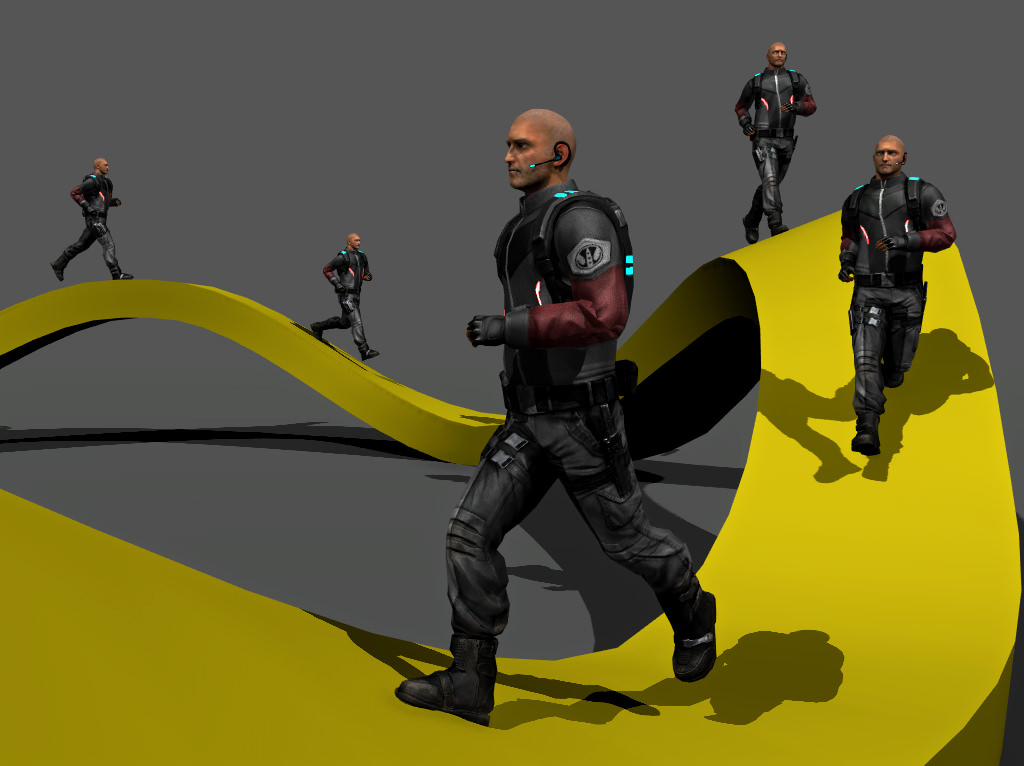

Combined Animation and Inverse Kinematics#
The problem with pre-baked animation is that it does not offer proper environmental interaction. For example, when walking up or down the hill, character's feet do not land firmly on terrain. Or as it climbs the ladder, the hands have to tightly grab the rungs. This effect is achieved with combined animation: motion animation is played for the basic bones, while smaller bones (feet or hands, for example) are simulated physically.
Frame-based animation can be disabled for each of the rigid bodies that approximate bones. Instead of following specific bone transformation, rigid body sags loose under its own weight and connects to collider objects underneath it.
For instance, physically-driven motion of the leg requires disabling bone animation of the whole limb: thigh, calf, and foot. Inverse kinematics allows to properly position the chain of bones given the position of the lowest bone in the hierarchy, the foot. So when the character walks or runs, his foot collides with the ground, while the knee bends and straightens according to the joint constrain.
Inverse Kinematics
With inverse kinematics feet of the characters are tightly glued to the floor no matter how tilted the surface is
