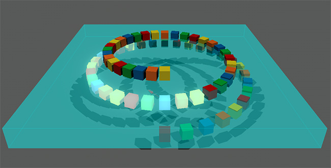

World Trigger is a cuboid shaped node that triggers events when any node (physical or not) gets inside or outside it. World Trigger can detect a node of any type by its bound and can be used to access node's components and parameters.
World Triggers detect only the nodes with Triggers Interaction enabled - either in the Editor or via API.

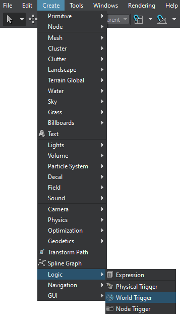

To create World Trigger via UnigineEditor:
  1. On the Menu bar, choose Create -> Logic -> World Trigger.
  2. Place the node in the scene.

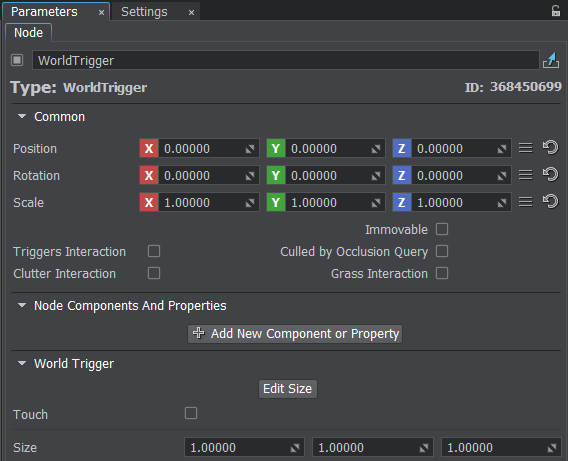

In the Node tab of the Parameters window, you can adjust the following parameters of World Trigger:
Node tab of the World Trigger node
Bounding Box Parameters#
A set of bounding box parameters:

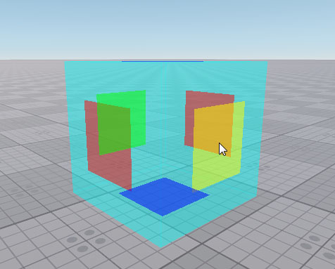

Edit Size
Toggles the editing mode for the World Trigger node on and off. When enabled, the bounding box sides that can be resized are highlighted with the colored rectangles. To change the size of a side, drag the corresponding rectangle.
Touch Toggles the touch mode for World Trigger on and off. With this mode on, World Trigger reacts to the node at a partial contact. Otherwise, World Trigger reacts only if the whole bounding box gets inside it.
Size The size of the World Trigger bounding box along the X, Y, and Z axes, in units.
