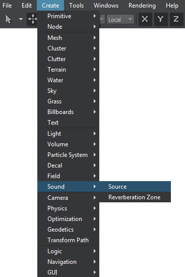

To create a sound source via UnigineEditor:
  1. In the Menu bar, click Create -> Sound -> Source.
  2. Place the sound source somewhere in the world.

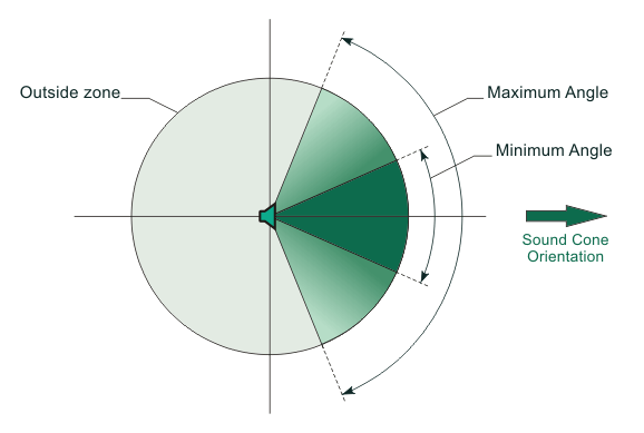

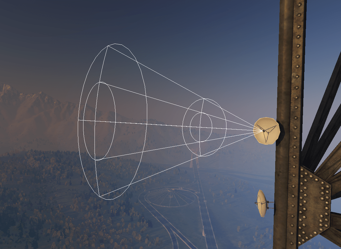

Oriented Cone#
A sound with no orientation has the same amplitude at a given distance in all directions. But it can be focused to a narrow beam and emitted only in one specified direction. To visualize this directional spread of a sound wave, the oriented cone is used. The vertex of the cone is the source itself. The direction of the oriented cone is changed by rotating the node. The inner and outer angles divide the area of sound coverage into the following zones:
  • The inner cone is defined by the minimum angle. If the angle equals 360 degrees, the sound source is omnidirectional. When inside the inner cone, the listener perceives the direct sound. It means that its loudness is specified by gain and no additional attenuation besides the distance-related one is applied.
  • The outer cone is defined by the maximum angle. If set to 360 degrees, the outer angle covers the entire world. if the inner angle is also 360, the zone for angle-dependent attenuation equivalent to the directional sound is zero. The gain in the outer cone is linearly extrapolated between the general gain and outside the cone gain values. It enables imitating smooth and gradual attenuation of sound.
  • The outside zone is the remaining sphere volume that is not included in the oriented cone. The sphere itself is limited to the maximum distance. The sound can still be heard outside the cone, but its attenuation must be different, meaning a separate gain value should be set.
Oriented Cone
Oriented Cone: inner cone (volume defined by Gain), outer cone (volume interpolated), and outside zone (volume defined by Outer Gain)
