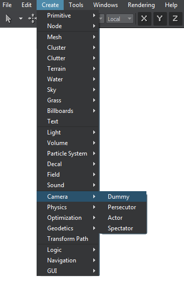

To create a Player Dummy, do the following:
  1. On the Menu bar, choose Create -> Camera -> Dummy.
  2. Place the camera somewhere in the world and specify the required parameters via the Parameters window.

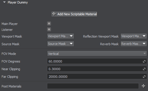

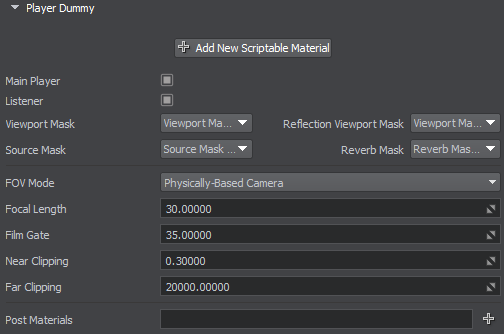

In the Player Dummy section of the Node tab, you can adjust the bit masks and viewing frustum parameters of the Player Dummy and assign post-process materials to be applied to the camera view.
Vertical Player Parameters
Physically-Based Player Parameters
