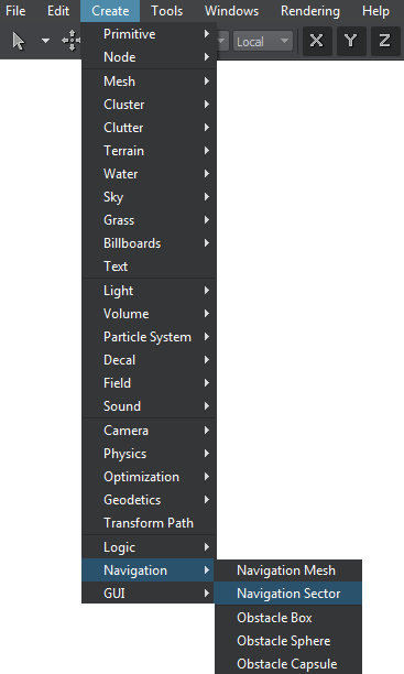

To create a navigation sector via UnigineEditor:
  1. Run UnigineEditor.
  2. On the Menu bar, click Create -> Navigation -> Navigation Sector.
  3. Click somewhere in the world to place the navigation sector.

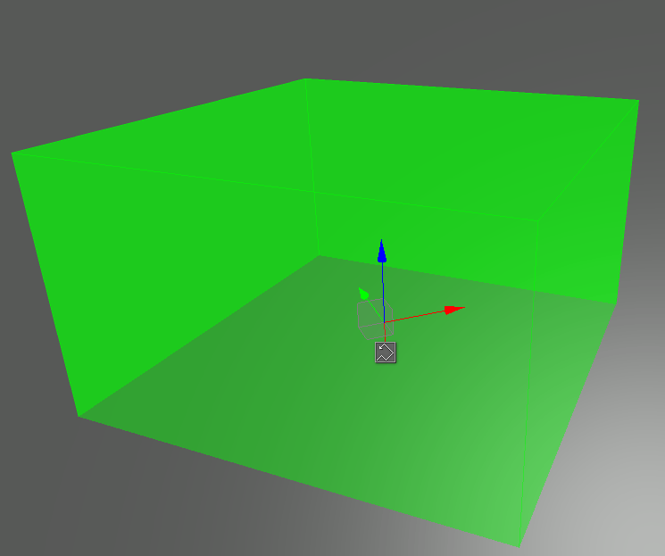

    A navigation sector
    A new navigation sector is added to UnigineEditor and you can edit it via the Parameters window.

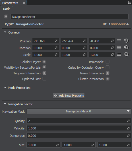

Editing Navigation Sector#
In the Node tab of the Parameters window, you can adjust the following parameters of the navigation sector:
Navigation Mask The Navigation mask of the navigation sector must match the Navigation mask of the route that is calculated within it. Otherwise, the sector does not participate in pathfinding. By using the Navigation mask, you can specify sectors that must be ignored during pathfinding.
Quality Quality of optimization for route calculation. This value specifies the number of iterations that are used to find the shortcut. The higher the value, the longer the route calculation will take.
Velocity Scaling factor for velocity of the point that moves inside the navigation sector along the calculated route.
Dangerous
Danger factor that indicates if a moving point should try to avoid the navigation sector.
If the danger factor exceeds the maximum danger factor set for the route, the navigation sector is excluded from pathfinding calculations.
Size Size of the navigation sector's box along the axes.
