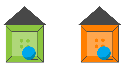

We have two houses with different color of the interior and put same objects (with reflection material, for example, metal) into these houses. What will happen?
If we don't speak about the dynamic reflections, you'll need to reflect the interior on each object. But interiors have different ambient color, and that is why you'll need to create 2 different materials for them. Not optimized at all.
Environment Probe removes this flaw. Once you added an object, you don't think about the reflection material for it. Environment Probe will map the cubemap to the object.

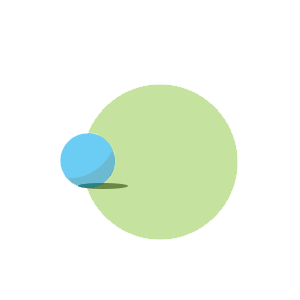

There is a difference in mapping cubemaps to transparent and non-transparent objects:
  • If an object is transparent, Environment Probe will map the cubemap only if the entire object is inside the radius of Environment Probe. Otherwise, the object won't be affected by Environment Probe at all.
  • If an object is non-transparent, Environment Probe will map the cubemap to any part of the object which is inside the radius of the probe.

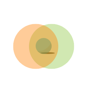

If you put several Environment Probe nodes that affect a non-transparent object (rendered in the deferred pass) their cubemaps will be blended smoothly. Here is an example, a long corridor which has walls painted in different colors.
We put two Environment Probe nodes and they both affect the object (when the object is in the intercrossing area). If you have large locations, you should use several Environment Probe nodes instead of one to make the final image more realistic.

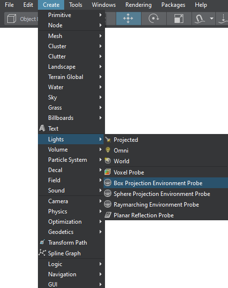

Adding Environment Probe#

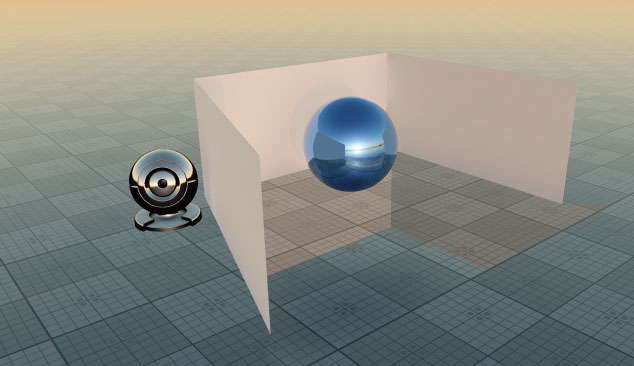

To add an Environment Probe node to the scene via UnigineEditor, do the following:
  2. On the Menu bar, click Create -> Lights and select the required Environment Probe: Box, Sphere, or Raymarching. The projection shape can be changed after it is created via the Parameters window.
  3. Place Environment Probe.
  4. Grab the cubemap texture for Environment Probe. You can grab it via the Parameters window or use the Bake Lighting tool.
  5. Adjust the Environment Probe settings.

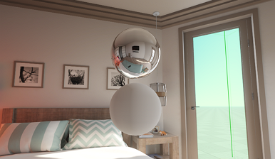

When Environment Probe is selected in the UnigineEditor viewport, reference spheres are visualized in the center of the probe:
  • Indirect Specular sphere helps in estimating the reflection provided by the probe.
  • Indirect Diffuse sphere helps in estimating the ambient lighting provided by the probe (requires Indirect Diffuse lighting to be enabled).

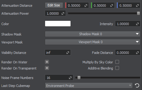

Render Parameters#
Color Sets the light color in the RGBA format. The color defines both the plausibility of virtual representation and its aesthetic component.
Intensity
Sets the light color multiplier, which provides fine control over color intensity of the emitted light:
  • The minimum value of 1 corresponds to the least saturated light color.
  • The maximum value of 100 equals the most bright and intense color.
Shadow Mask The Shadow mask controls rendering of a shadow cast by an object lit by a light source.
Viewport Mask Sets the Viewport mask for the light.
Visibility Distance Distance from the camera, in units, up to which Environment Probe will be rendered.
Fade Distance Distance from the camera, in units, starting from which Environment Probe starts to fade out gradually.
Render On Water Renders Environment Probe on the water surface.
Render On Transparent Renders Environment Probe on transparent surfaces.
Multiply By Sky Color
Enables the influence of sun light color on Environment Probe.
When enabled, this option makes the Environment Probe color black at night, or orange at sunset.
Additive Blending Enables the additive blending mode for Environment Probe. This option offers more flexibility in lighting and reflections control. You can use it to blend lighting and reflections of several Environment Probe nodes together and control them separately.
Rendering Order
Order in which multiple Environment Probes are rendered. A higher value means a higher priority.
Render Above Voxel Probes
Toggles rendering of the Environment Probe above Voxel Probes (or other Environment Probes) to imitate the GI bounce from the sun. If enabled, the Environment Probe is additively blended with Voxel Probes (or other Environment Probes). In case of several Environment Probes having this setting enabled, they are rendered according to the specified Rendering Order.
Noise Frames Number The number of variations of the noise pattern, which is changed every frame. Higher values result in a more dynamic noise effect, but a significant temporal accumulation of frames will make the image look like more rays are used. Smaller values result in a more static noise pattern.
Secondary Bounce Projection Specifies the type of the secondary bounce projection used for dynamic reflections. It determines how secondary light bounces are calculated and projected, impacting the quality of dynamic reflections. The following projection types are available:
  • Sphere Projection - this type uses a spherical approximation to calculate secondary light bounces. It offers significantly higher performance than Raymarching and allows you to avoid noise in the secondary bounce.
  • Raymarching - this type calculates secondary light bounces by tracing rays through the scene. While this method is more physically correct, it has low performance and introduces noise into the secondary bounce.
Last Step Cubemap
Allows selecting the cubemap to be used for the last raymarching step:
  • Environment Probe — the cubemap used for the last step is the same as for all previous steps.
  • Only Sky — the cubemap contains the sky and clouds only. This option is designed to fix the incorrect parallax that may occur in reflections due to the infinite length of the last step.

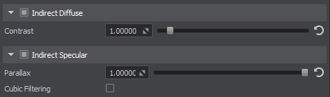

Sphere Projection#
Sphere Projection Parameters
Contrast Sets the contrast of indirect diffuse lighting.
Parallax
Enables rendering of reflections taking into account the camera's position. When this option is disabled, reflection cubemaps are simply projected onto objects, and do not follow the viewer's perspective.
  • 0 (minimum) — parallax correction is disabled (reflections will look like objects are infinitely distant).
  • 1 (maximum) — parallax correction is enabled (reflections will look like objects are at the distance close to the radius of Environment Probe).
  • Values in-between represent a linear interpolation factor for parallax correction and are to be set when Environment Probe is used to fit a medium or small object into the environment for additional correction, if necessary.
Parallax correction does not affect reflections on transparent objects.
Cubic Filtering
Enables bicubic interpolation for the Enviropment Probe cubemap instead of the standard bilinear interpolation. This effect is only applicable to reflected lighting and calculated if a pixel has a low Roughness value. Modifications are applied only to the first mip of the cubemap. The effect visually represents slight blurring of neighboring pixels. However, this is not antialiasing and might affect the visual quality of high-resolution probes.
This option may be combined with sRGB Filtering Correction to achieve a better gradient between pixels.
  • Enabling this option affects performance, thus it is recommended to enable it only for Environment Probes affecting a big number of reflective/mirror pixels, especially if it is a realtime low-resolution Probe.
  • For this option to have an effect on a transparent sufrace, the Reflection Cubic Filtering state should be enabled for the material (for non-transparent materials the option is applied automatically).
  • The option does not affect Impostors.

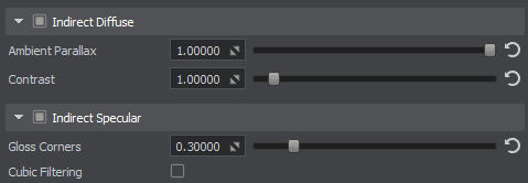

Box Projection#
Box Projection Parameters
Ambient Parallax Enables the global illumination simulation. Environment Probe generates fake GI by using the cubemap.
Gloss Corners The intensity of reflection gloss near the box projection corners.
Cubic Filtering See above.

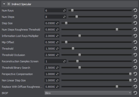

Raymarching#
Raymarching Parameters for Indirect Diffuse Raymarching Parameters for Indirect Specular
Num Rays The number of rays per pixel that are used to calculate diffuse/specular reflections from rough surfaces. Using more rays provides more precise reflection roughness calculation, however, it is more expensive.
Num Steps The number of steps per ray that are used for trace calculation. The number of steps defines accuracy of indirect light / reflections and causes a reasonable performance impact. The higher the value, the more accurate obstacles between objects are taken into account.
Step Size The size of the trace step used for the diffuse/specular reflection calculation. Higher values result in longer traces (however, tiny objects may become missing), lower values produce more detailed reflections of tiny objects.
Num Steps Roughness Threshold The roughness value at which the number of steps (Num Steps) equals to 1. This is required for optimization, as calculating matte reflections as correctly as possible may be unnecessary.
Information Lost Rays Multiplier The multiplier for the number of rays (Num Rays) in the areas where the ghosting effect usually occurs. Increasing this value reduces the ghosting, but the more ghosting cases are, the more it affects performance.
Mip Offset The mipmap offset for the cubemap that is used for the diffuse light / specular reflections calculation. Increasing the value affects performance, lighting turns to be less detailed and realistic, small objects on the cubemap may be lost. The 0 value provides the most visually credible result, but more rays are required to eliminate the noise.
Threshold The threshold used for the diffuse light / specular reflections calculation to limit imitation of reflections in areas where information can't be obtained. Higher values make the effect less pronounced.
Threshold Occlusion The value that limits imitation of environment cubemap occlusion in areas where information can't be obtained. Higher values make the effect less pronounced. This parameter is mainly used for indoor environment to correct false reflections on occluded areas (false reflections are replaced with black color). For outdoor environment, higher values of this parameter are recommended.
Reconstruction Samples Screen The number of iterations required for a more accurate detection of the screen-space ray-surface intersection. Higher values define the intersection more precisely, however significantly affect performance.
Threshold Binary Search Threshold value used for the intersection detection that defines the depth of the ray penetration under the surface. Higher values may cause more false intersections, but make the process of intersection detection easier.
Perspective Compensation Perspective compensation for the raymarching step size. 0 means that the raymarching step size is bound to the World Space, and 1 means that it is bound to the Screen Space. As a result, at the value of 1, the ray length at the distance from the camera will be more than at a closer distance, which makes sense for large objects, but the details on small objects in the distance may will be lost.
Non Linear Step Size Raymarching step size adjustment value. The value of 0 means that the step size is the same for each step, and at the value of 1 each subsequent raymarching step is twice wider than the previous one.
AO Intensity Ambient occlusion intensity. Keep in mind that ambient occlusion doesn't exist in the real world, this is a method to imitate shadows between objects. For photorealistic visualization, we recommend keeping this value equal to 0.
AO Radius Radius of sample pixels used in the Ambient Occlusion effect, controlling the extent of the darkened area.
Translucent Anisotropy
The value defining the extent of the light penetration through transparent surfaces.
  • 0 — light does not penetrate through surfaces.
  • 0.5 — light is distributed equally on both sides of the surface (along the ray direction and towards the light source)
  • 1.0 — all light passes through the surface along the ray direction.
Replace With Diffuse Roughness Threshold The rougness value starting from which Indirect Specular stops being calculated and is replaced with Indirect Diffuse. This setting is used to optimize matte reflections.
BRDF The light distribution model for matte surfaces. GGX is more realistic, though increases noise and slightly reduces performance.

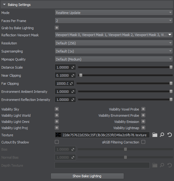

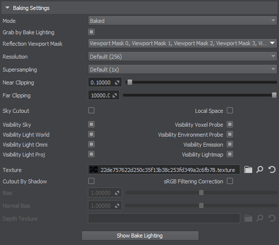

Baking Settings#
Baking Settings for Baked Mode Baking Settings for Realtime Update Mode
Re-grab the cubemap texture, when you make changes to these parameters.
Mode
Specifies if the reflection is updated in realtime or baked into a texture.
For the Realtime Update mode, the Dynamic Reflections option should be enabled: Rendering -> Features -> Dynamic Reflections.
Faces Per Frame
Cubemap update interval:
  • 1 — Refresh only one face every frame.
  • 2 — Refresh two faces every frame.
  • 3 — Refresh three faces every frame.
  • 4 — Refresh four faces every frame.
  • 5 — Refresh five faces every frame.
  • 6 — Refresh all six faces every frame.
Available for the Realtime Update mode or Raymarching environment probes.
Grab by Bake Lighting Specifies if the cubemap texture is to be modified by the Bake Lighting Tool.
Reflection Viewport Mask The mask that controls rendering of the Environment Probe's reflections into the reflection camera viewport.
Resolution
Resolution of the reflection texture, in pixels.
Setting too high resolution on a low-performance GPU with low memory capacity may cause engine crash.
Supersampling Number of samples per pixel used for image grabbing supersampling.
Mipmaps Quality
The quality of mipmaps for environment reflections on rough surfaces. Quality modes differ in the number of rays used to create a reflection on a rough surface.
  • Setting too high quality on a low-performance GPU with low memory capacity may cause engine crash.
  • Available for the Realtime Update mode or Raymarching environment probes.
Distance Scale
Global distance multiplier within the range of [0.0f; 1.0f] for the reflection LODs visibility distance. Distance Scale is applied to the distance measured from the reflection camera to the node (surface) bound.
