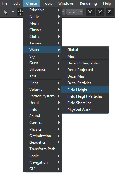

To add a height field in the world via UnigineEditor, do the following:
  1. On the Menu bar, choose Create -> Water -> Field Height.
  2. Place the height field in the world so that it intersects Global Water object.
    Make sure that the FieldHeight interaction option is enabled for water_global_base material.

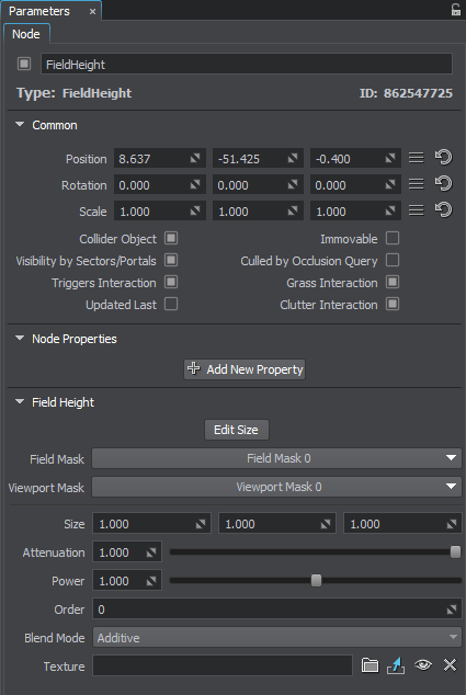

  3. Go to the Field Height tab of the Parameters window and set up necessary parameters.
After adding a Field Height object to the scene, you can't see any changes of the global water object because Field Height object doesn't have any default heightmap texture.
Setting Up Field Height#
In the Field Height section (Parameters window -> Node tab), the following parameters of the height field can be adjusted:
Setting Bit Masks#
Field Mask A Field mask. A bit mask that specifies an area of the height field to be applied to water. The height field will be applied to water only if they have matching masks.
Viewport Mask A Viewport mask. A bit mask for rendering the height field into the current viewport. For the height field to be rendered into the viewport, its mask should match the camera Viewport mask.
Setting Height Parameters#
Size Size of the height field along the axes in units.
Attenuation An attenuation factor indicating how much global water object's heights gradually changing from the center of the height field.
  • The higher the value, the less heights of the Field Height will have influence on the heights of the Global Water object.
Power Power parameter is a multiplier for FieldHeight heightmap texture values.
  • The higher the value, the more heights of the Field Height will have influence on the heights of the Global Water object.
Order Rendering order of the Field Height. This parameter is used to properly apply fields with mixed blend modes.
Blend Mode Bending mode of the Field Height. Available values are Additive, Multiplicative.
The Attenuation parameter is interpreted depending on the selected blending mode:
  • It is used as a multiplier for the Additive mode.
  • lerp(1.0f, value, attenuation) is used for the Multiplicative mode.
Texture Heightmap R16 or R32F (1-channeled) texture (controlled by the render_field_precision console command). Heightmap texture is used to create an additional height displacement for water surface.
