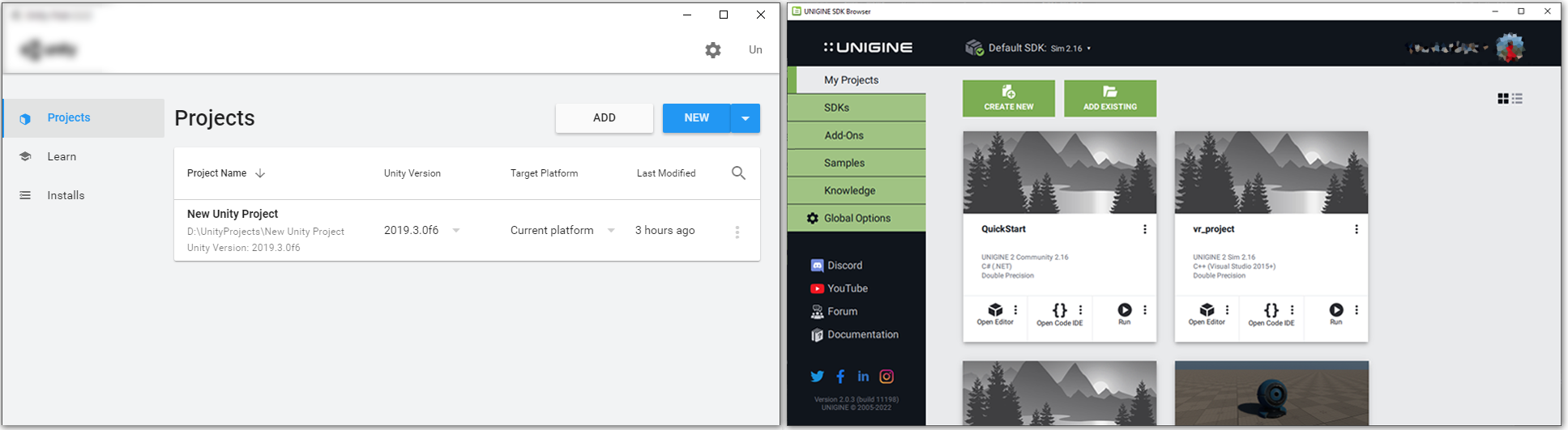

As a Unity software user, you are accustomed to use Unity Hub — the application that streamlines the way you find, download and manage your projects and installations.
UNIGINE SDK Browser is the first step to start working with UNIGINE Engine. This application enables you to manage your projects and installed SDKs, as well as gives you access to the samples and the knowledge base.
Unity Hub and UNIGINE SDK Browser Comparison (click to enlarge)

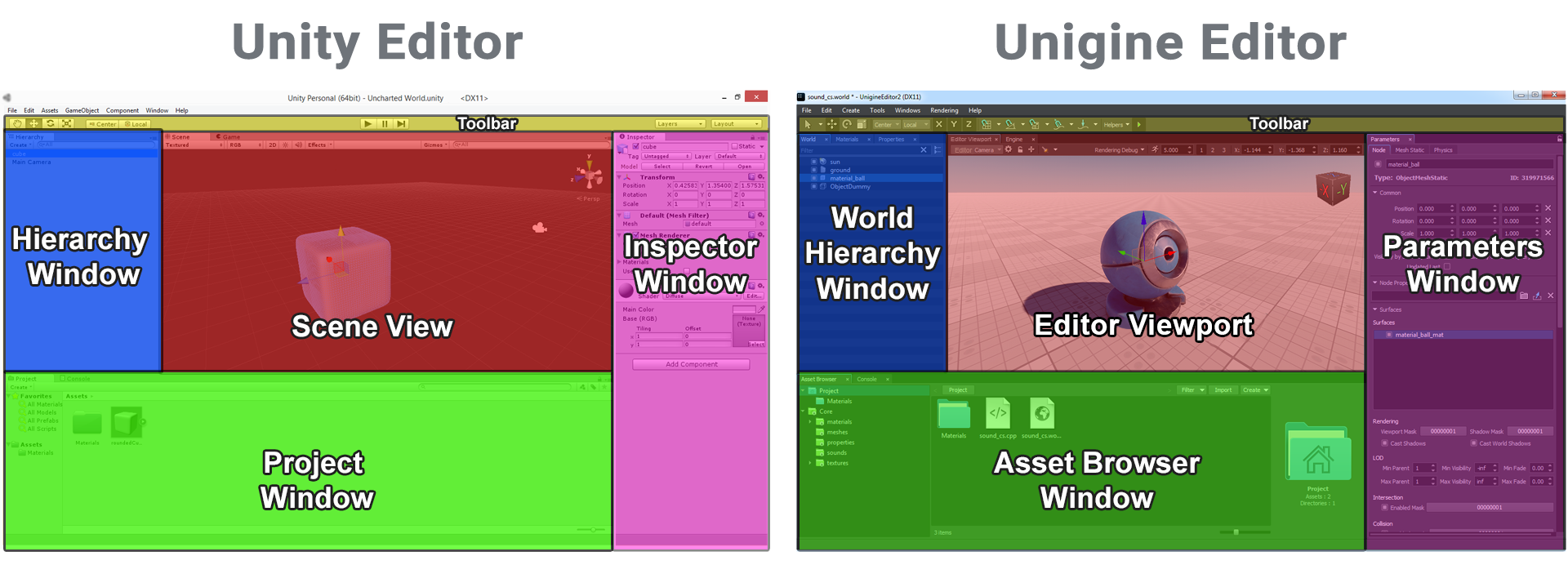

Editor Interface#
Below you can see interfaces of Unity Editor and UnigineEditor. Interface elements in the images are color-coded to indicate common functionality. Each element has a label to show UNIGINE's equivalent. The layout of UnigineEditor is fully customizable by resizing, dragging and dropping the tabbed windows. UnigineEditor adopts a dark color scheme.
Unity and UNIGINE Editor UI Comparison (click to enlarge)
Unity Editor and UnigineEditor UI Comparison
To learn more about the UnigineEditor interface, read this article.

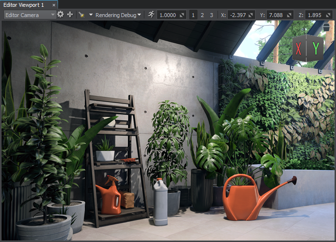

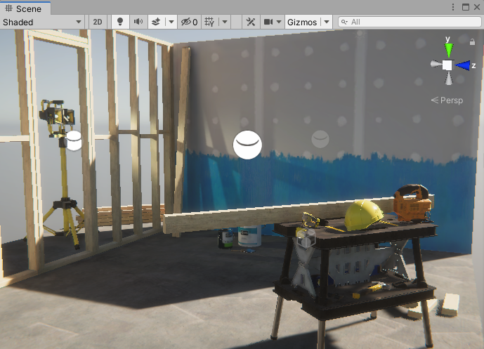

Scene View#
You may find the Scene View and the Editor Viewport controls looking very much alike.
Unity Scene View
UNIGINE Editor Viewport

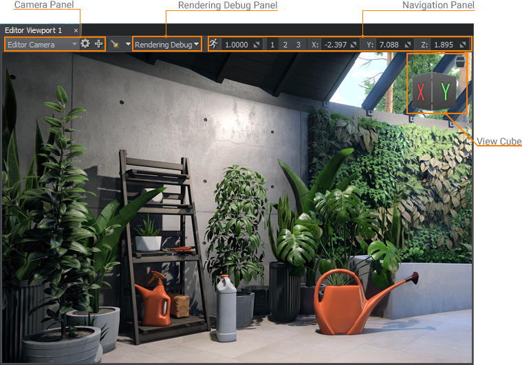

You can use:
  • Camera panel to switch between cameras and configure the current one.
  • Rendering Debug to display the contents of rendering buffers the same way as using the Draw Mode in Unity Editor.
  • Navigation panel to quickly set up and switch between camera speed presets and change the camera position.
Navigation inside the Editor Viewport is pretty much the same as in Unity Scene View. However, get familiar with Scene Navigation so as not to miss details.

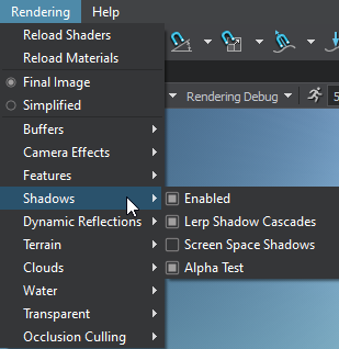

Also, a set of global switchers is available in the top toolbar:
You can use as many Editor Viewports as you need.

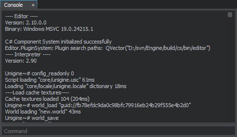

Console#
As well as Unity software, UNIGINE has the Console used for standard input, output and error logging. A set of console commands is provided.
It is available both in UnigineEditor and a running application. To open the Console window in the Editor, go to Windows -> Console menu:
A built-in console is called by pressing the F1 key:
You can use it to print user messages from code.

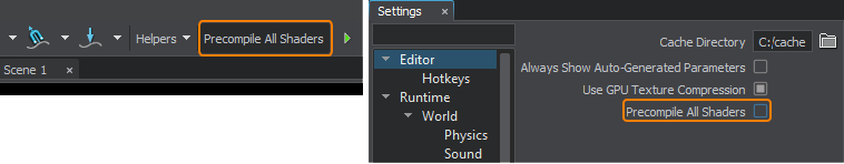

Shader Compilation#
In Unity Editor, Asynchronous Shader compilation is toggled on and off in the Editor settings (menu: Edit > Project Settings > Editor > Shader Compilation).
In UNIGINE, a similar editor feature, Forced Shader Compilation, is available via both the toolbar and the Editor section of the Settings window.

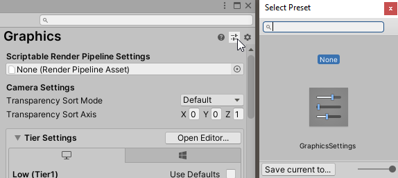

You use Presets in Unity Editor when you need to reuse property settings that have bearing to different tasks, be it component settings, import settings or especially Project Settings. You can save the settings preset for a certain section of the Project Settings as a .preset asset and reuse in development later.
Presets are an Editor-only feature in Unity software.

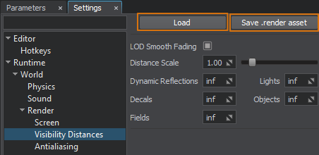

In UNIGINE, you can save and load presets for general physics, sound and render settings. The presets are stored as assets with the *.physics, *.sound and *.render extensions respectively. Use Load and Save .* asset buttons of the Settings window to work with presets of the corresponding settings section.
Saved assets appear in the Asset Browser. You can load the render settings by double-clicking the required .render asset.
By default, a UNIGINE project provides settings for low, medium, high, ultra and virtual reality quality presets stored in the data/template_render_settings folder.
Presets are not an Editor-only feature in UNIGINE. You can use Physics, Sound and Render classes to manage presets for corresponding settings, for example, to switch between quality levels at run time.

Texture Quality Render -> Textures -> Quality
Anisotropic Textures Render -> Textures -> Anisotropy
Anti Aliasing Render -> Antialiasing -> Supersampling
Soft Particles particles_base -> Soft Interaction
Realtime Reflection Probes Menu: Rendering -> Dynamic Reflections -> Enabled
Texture Streaming Render -> Streaming Settings
Shadows Render -> Shadows Settings
Shadow Cascades set per each World Light source
VSync Count Runtime -> Video settings
