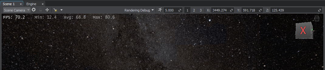

Configuring the Star Field#
Star field intensity might seem too low by default. You may need to adjust brightness level of your displays or increase maximum brightness of the star field for your area.

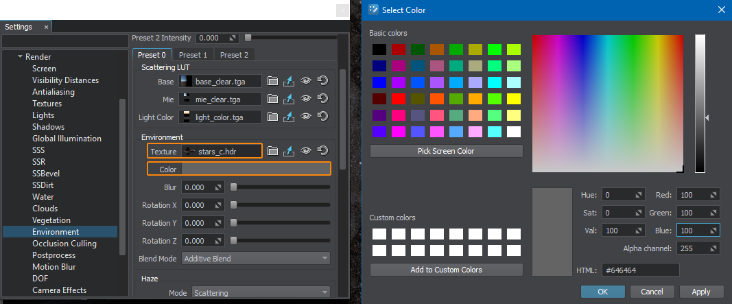

To set up the stars and make them look brighter do the following:

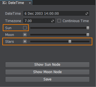

  1. Temporarily disable the sun node in the IG:DateTime window of the IG Editor Plugin and make sure the Stars intensity is set to high value.
  2. Open Environment Settings (Windows -> Settings -> Runtime/World/Render/Environment).
  3. Set the Environment Texture to stars_c.hdr.
  4. Click Environment Color and increase values of RGB color components until you reach the desired color and brightness of the star field (e.g., to 100,100,100).
    The Alpha channel is used by the system to control Star Intensity (e.g., via CIGI).
  5. Enable the sun node back again and save your world.

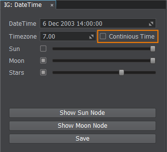

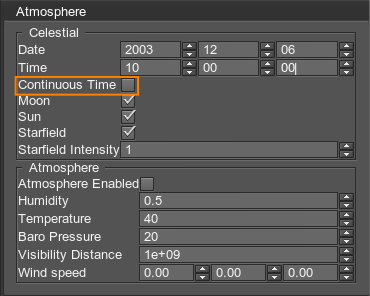

Stars are positioned on the sky automatically, depending on the date/time and geographic location.
Enable the Continuous Time option to make the star field move simulating the Earth rotation via IG Editor Plugin or IG Host.

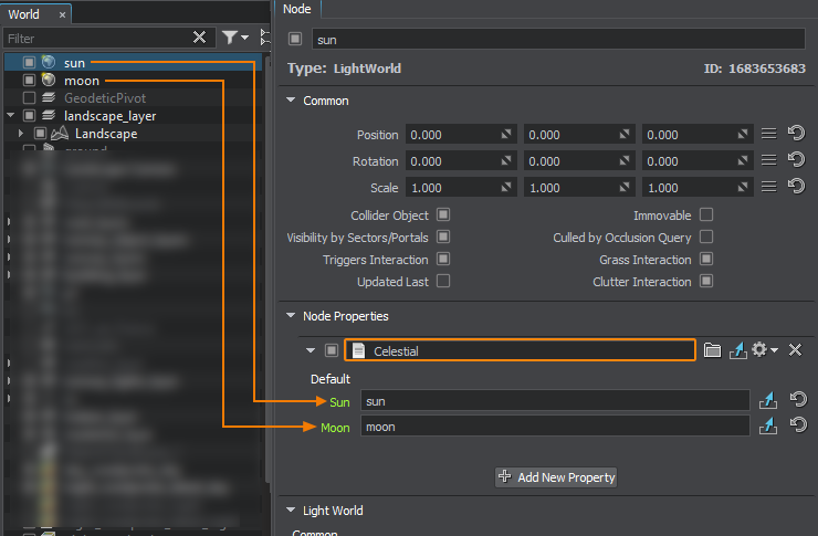

Configuring Sun and Moon#
IG has a built-in celestial body control (celestial_control packet). In order to use it, you should have:
  • Two nodes, one for the Sun, and one for the Moon
  • The Celestial property assigned to the sun node
  • Parameters of the Celestial property containing links to the corresponding nodes.
Positions of the Sun and the Moon are adjusted automatically depending on the date/time and geographic location.

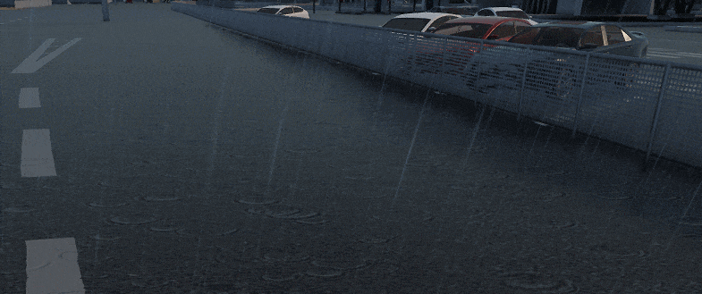

Precipitations#
Precipitations start playing via particles when the active camera gets inside the region with the corresponding precipitation layer enabled.
A precipitation layer can be set up either via the IG Editor Plugin or by the means of IG Host.

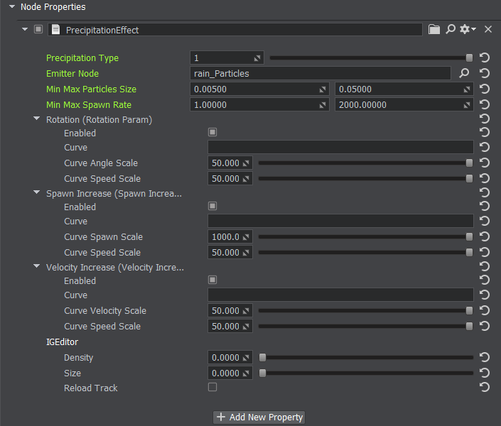

Adjusting Precipitations Appearance#
To adjust specific parameters for rain or snow (spawn rate, size of raindrops/snowflakes, etc.) select the IG precipitation node in the World Nodes window and tweak the parameters of the PrecipitationEffect property assigned to it.
The following parameters are available:
  • Precipitation Type — type of precipitation (rain or snow).
  • Emitter Node — particles node that simulates the effect.
  • Minimum and Maximum Particles Size — limits for random particles size.
  • Minimum and Maximum Spawn Rate — limits for spawn rate value.
  • Rotation — rotation parameters for particles based on the camera movement.
    • Enabled — enables the particles rotation.
    • Curve — sets the interpolation curve for rotation (linear interpolation when the curve is not specified).
    • Curve Angle Scale — maximum deflection angle.
    • Curve Speed Scale — maximum speed when the maximum deflection angle is achieved.
  • Spawn Increase — spawn increase parameters for particles based on the camera movement speed.
    • Enabled — enables the spawn increase.
    • Curve — sets the interpolation curve for spawn increase (linear interpolation when the curve is not specified).
    • Curve Angle Scale — maximum spawn rate.
    • Curve Speed Scale — maximum speed when the maximum spawn rate is achieved.
  • Velocity Increase — velocity increase parameters for particles based on the camera movement speed.
    • Enabled — enables the velocity increase.
    • Curve — sets the interpolation curve for velocity increase (linear interpolation when the curve is not specified).
    • Curve Angle Scale — maximum velocity.
    • Curve Speed Scale — maximum speed when the maximum velocity is achieved.
  • IGEditor — editable parameters for preview in Editor.
    • Density - particles density.
    • Size - particles size.
    • Reload Track - reloads the track file.

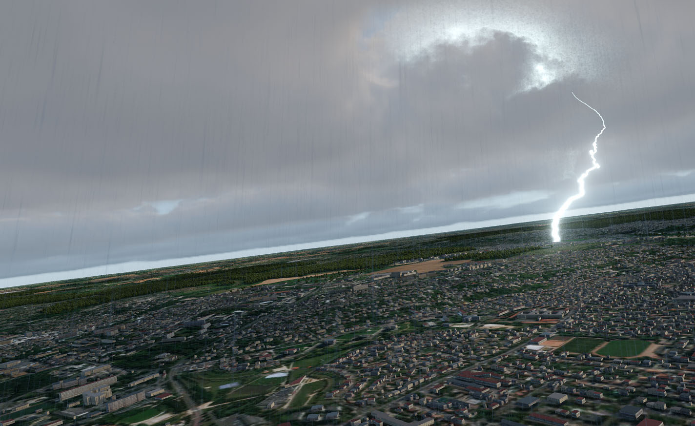

Lightning#
Lightnings are particles that get spawned and played inside a layer’s volume. They can be enabled with any type of layer.
Lightning parameters can be set up either via the IG Editor Plugin or by the means of IG Host.

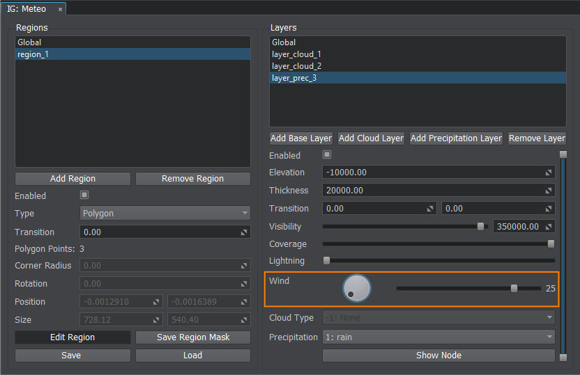

Wind#
Particle Systems (rain, snow, and so on) can be affected by the wind controlled by IG when they get inside a region with wind enabled. Wind also affects the cloud movement in cloud layers.
Weather layer wind changes global Animation Scale and Animation Wind for Vegetation depending on player's position inside weather layers.
To adjust the wind, go to IG:Meteo window, select a region and a layer inside of it. Use manipulators to specify the direction and force of the wind inside the layer.
Wind can also be set up via the IG Host.

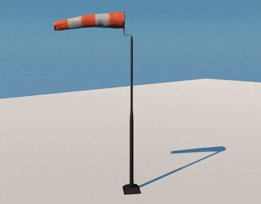

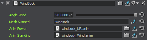

For your convenience, we have also added the windsock.node asset to the IG Template, it is available in ig_data\objects\windsock\.
This asset is already preconfigured to be affected by the IG wind via the WindSock property.
  • Angle Wind — additional angle rotating the mesh to align it with the wind direction.
  • Mesh Skinned — the windsock mesh.
  • Anim Power — animation of the windsock deformation depending on the wind speed variation.
  • Anim Standing — animation of the windsock rippling.
