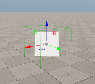

  1. Create a Billboards: click Create —> Billboards —> Base on the Menu bar.
  2. Inherit the surface material and enable the Emission state. You can change the emission color and any other parameters in the Parameters tab.
  3. Export the object to a *.node file.
The *.node file should contain a single Billboards object.

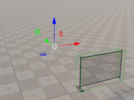

An important issue about placing objects along the lines is the node's pivot point: it should be shifted, if you want a fence to be generated near the road, not in the middle of it. To do this, open the asset in a third-party Digital Content Creation software.
The width of the plane that we created for the road is 10 units, therefore we need to move the fence more than 5 units from the pivot, so that it wouldn't be on the road.
The reimported model will look as follows:
Fence with a shifted pivot

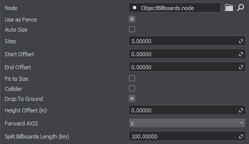

  1. Select the created Node Reference as Node.
  2. Enable the Use as Fence option.
  3. Disable the Autosize option.
  4. Set 5 as the value for the Step parameter that determines the distance (in units) between the two adjacent lights (Billboards) placed along the road.
  5. Click the Create Point Object button.

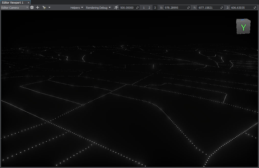

The generated lights will look as follows (if you disable the sun light):

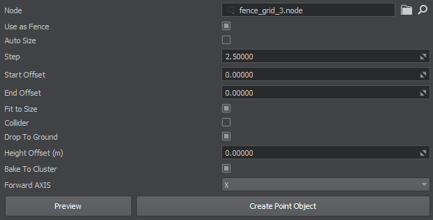

And set the following parameters for the object:
  3. Click the Create Point Object button.
