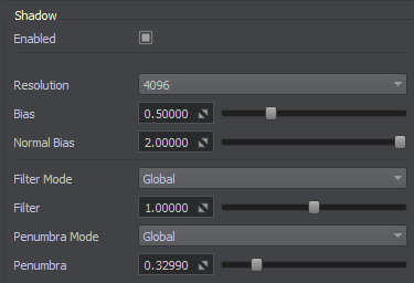

To enable shadow casting from a light source, check the Enabled option in its Shadow Settings:

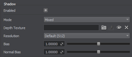

  4. In the Shadow Settings, select the Static shadow mode and Resolution of the shadow map.

  5. In the Shadow Settings, select the Mixed shadow mode and Resolution of the shadow map.
