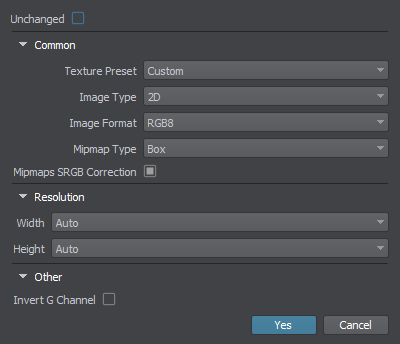

You can import textures in convenient formats (such as .tga, .jpg, .png, .hdr, etc.). As you import a texture via the Asset Browser, using drag and drop or the Import button, the following import settings are displayed. These settings can also be changed later via the Parameters window.
Import settings for a texture asset
Common Parameters#
Unchanged
Defines whether the texture is to be used "as is" or a runtime will be created for it in accordance with the specified import options.

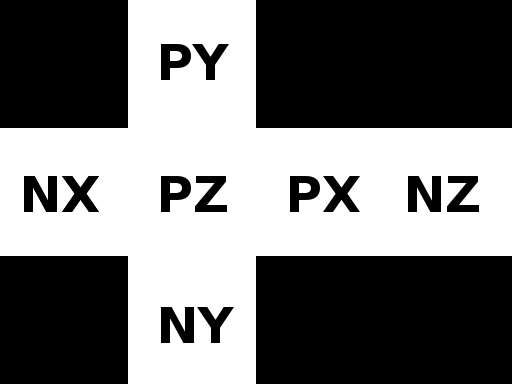

  • Cube — cubemap texture. It can be used for your world's environment, sky dome or Environment Probe. The imported cubemap will be oriented the following way:
    The following layouts of source cubemaps are supported:
    Horizontal cross layout Vertical cross layout Cylindrical Panorama

Image Format
Defines the image pixel format: bit depth and channels used. Compressed formats are supported. The default format is RGB8.
The drop-down menu contains all possible formats. However, if an unsuitable format is selected for the texture, the image would not be imported properly. For example, the normal texture accepts ATI2 files only. For more details on formats, see the description of the texture asset format.

Invert G Channel
Enable inversion of the green channel of the imported image. Depending on the game engine or 3D software package you use, normal maps can be handled differently. This option is used to simplify conversion of normal maps from different source platforms.

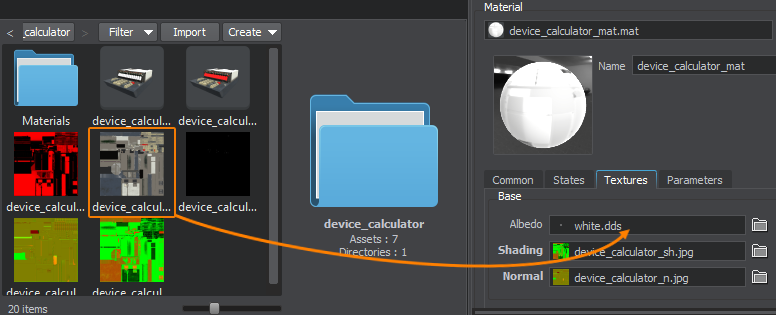

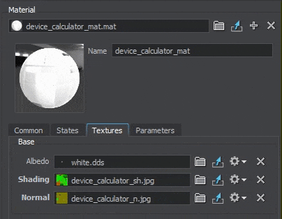

Assigning Imported Texture#
To assign the imported texture to a material, you can choose one of the following ways:
  • Drag the icon of the texture asset from the Asset Browser window to the destination field in the Parameters window.
  • Use the button next to the destination field in the Parameters window to select the desired asset.
  • Type the name of the asset to the destination field in the Parameters window manually. If an asset with the specified name exists in the project it will be shown while you type.

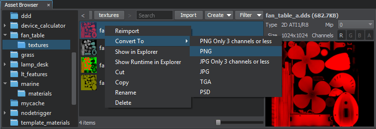

Texture Conversion#
Texture Conversion is a feature that allows optimizing a texture at a later stage of the project without changing the asset GUID, thus preserving all necessary links. Any texture asset used in your project can be converted to one of the available formats.
To convert a texture, right-click the texture in the Asset Browser to open the context menu, and select Convert To and the required file format. The file immediately will be converted to a selected format.
