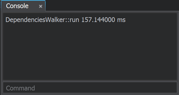

Information on time spent to complete these processes can be printed to the console and the log file: you just need to set the UNIGINE_EDITOR_TIME_TRACE environment variable.

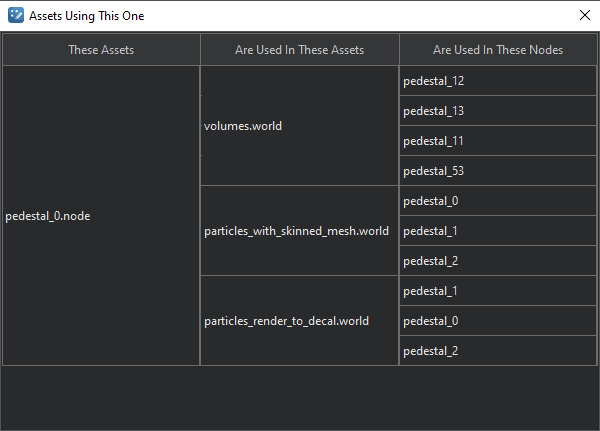

Show Assets Using This One#
These Assets The selected asset or assets.
Are Used in These Assets All the assets in which the selected asset is used.
Are Used in These Nodes All the nodes in which the selected asset is used within the specific asset.

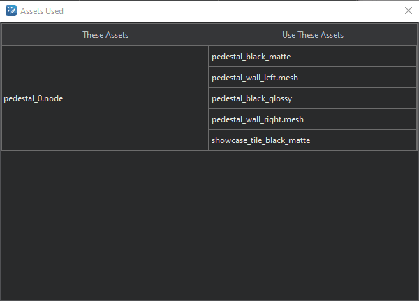

Show Assets Used#
Use These Assets All the assets (materials, textures, FBX, meshes, properties, etc.) that compile the selected asset.
