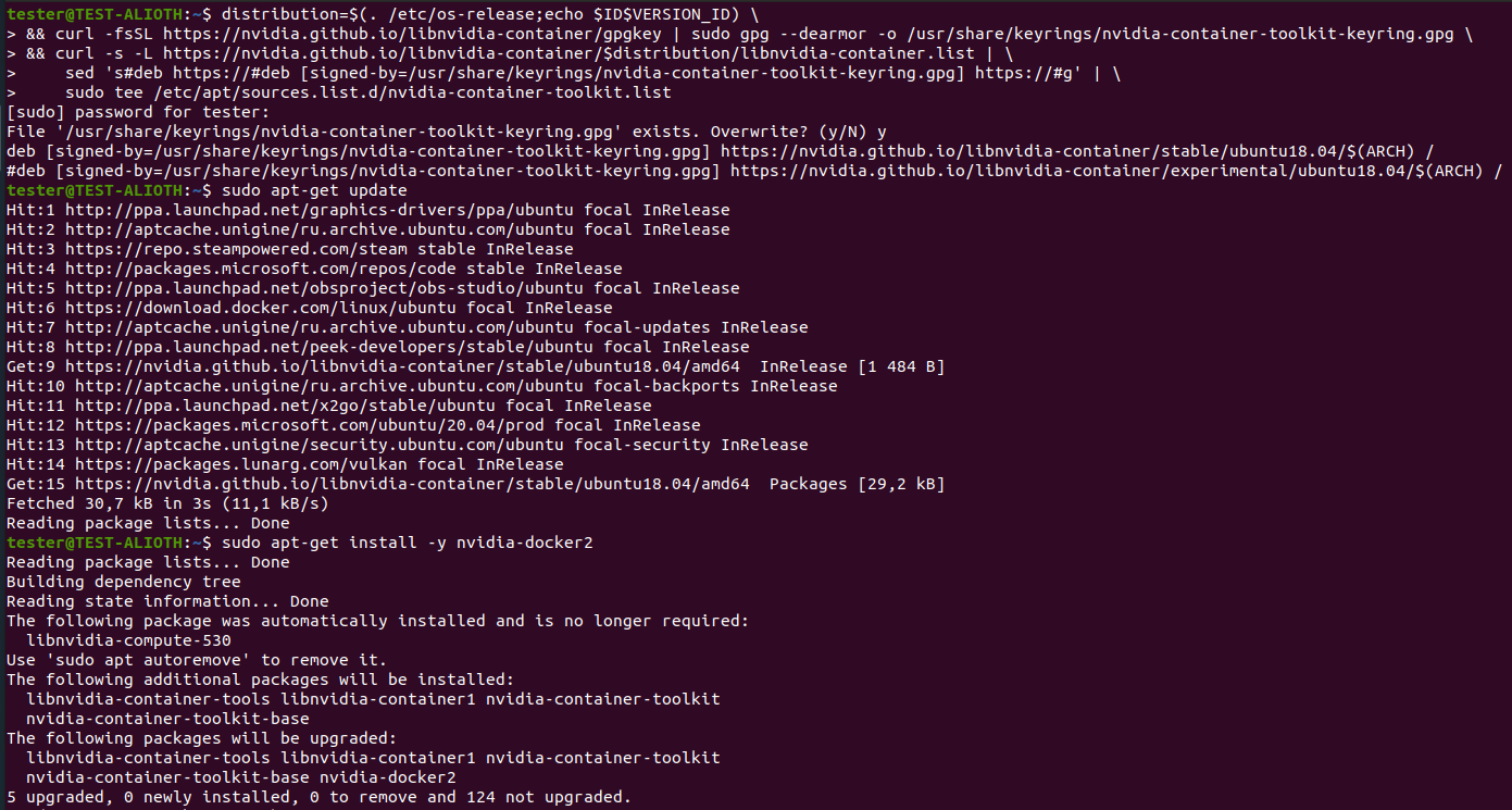

  1. Configure NVIDIA Container Toolkit according to its configuration documentation. Install the package repository and the GPG key, type the command line for that:
    Output
    $ distribution=$(. /etc/os-release;echo $ID$VERSION_ID) \
    && curl -fsSL https://nvidia.github.io/libnvidia-container/gpgkey | sudo gpg --dearmor -o /usr/share/keyrings/nvidia-container-toolkit-keyring.gpg \
    && curl -s -L https://nvidia.github.io/libnvidia-container/$distribution/libnvidia-container.list | \
        sed 's#deb https://#deb [signed-by=/usr/share/keyrings/nvidia-container-toolkit-keyring.gpg] https://#g' | \
        sudo tee /etc/apt/sources.list.d/nvidia-container-toolkit.list
  2. Install nvidia-docker2:
    Output
    $ sudo apt-get update
    $ sudo apt-get install -y nvidia-docker2
  3. Restart Docker:
    Output
    $ sudo systemctl daemon-reload
    $ sudo systemctl restart docker

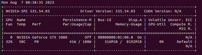

  2. Launch the container in trial mode to view GPU characteristics:
    Output
    $ cd ~/unigine-in-docker/
    $ docker run -it --rm --network host \
    --runtime=nvidia --gpus 0 -e NVIDIA_VISIBLE_DEVICES=0 \
    -e DISPLAY=${DISPLAY} \
    -e NVIDIA_DRIVER_CAPABILITIES=display,compute \
    -v /tmp/.X11-unix:/tmp/.X11-unix \
     unigine/run-unigine-in-docker:latest \
     /bin/bash
    # nvidia-smi
