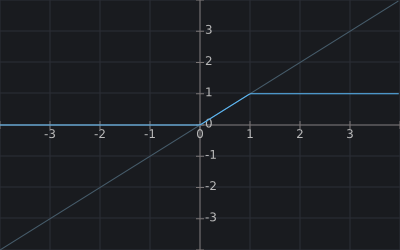

Outputs the input value clamped between 0 and 1.
  • 0 is returned if input is less than 0
  • value is returned if input is between 0 and 1
  • 1 is returned if input is greater than 1
