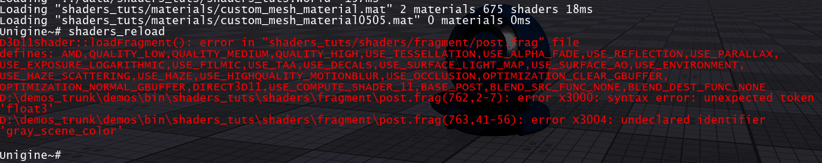

Sure. If there is a shader error, the engine shows it in the console:
The message contains information about which file has errors and their description (including the number of line).
Export the shader file to the file and find this code line to figure out what's happen. Shader will be exported in a file with the graphic API shader format (.hlsl) located relatively to the data folder.
