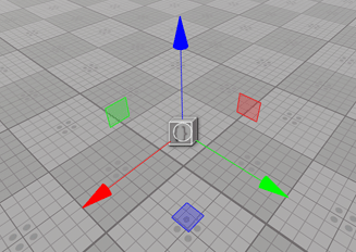

Step 1. Add The Primitive Object To The World#
  1. Open the project in UNIGINE Editor via the SDK Browser.

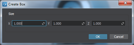

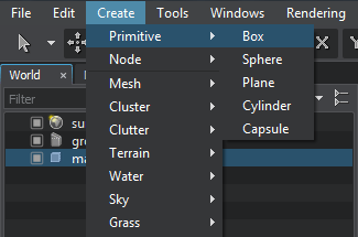

  2. In the Menu Bar, choose Create -> Primitive -> Box to create a box object.

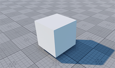

  3. In Create Box window that opens, specify the size of the box and click OK.

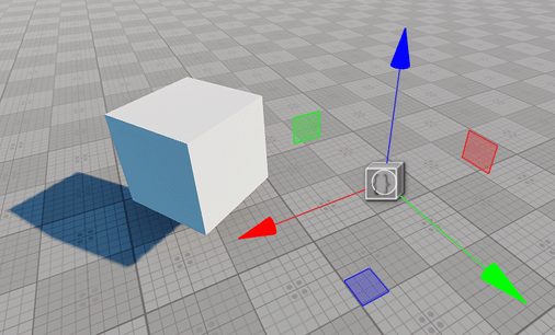

  4. Place the box somewhere in the world.

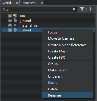

  5. By default, the added node is named Cuboid. Right-click it in the World Hierarchy window and rename it box.
  6. In the Node tab of the Parameters window, change the position of the box to 0.0, 0.0, 1.0.
  7. In the Menu Bar, click File -> Save World or press CTRL + S to save the world.

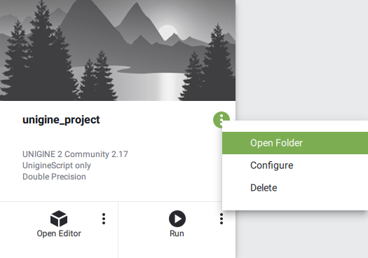

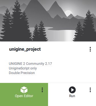

  1. Open the project folder via the SDK Browser.
    If there is no Open Folder button, choose Other Actions -> Open Folder.
  2. Open <your_project_name>.usc script file located in the data directory by using plain text editor.

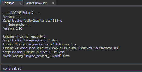

  7. In the Menu Bar of UnigineEditor, choose File -> Reload World or run the world_reload console command.

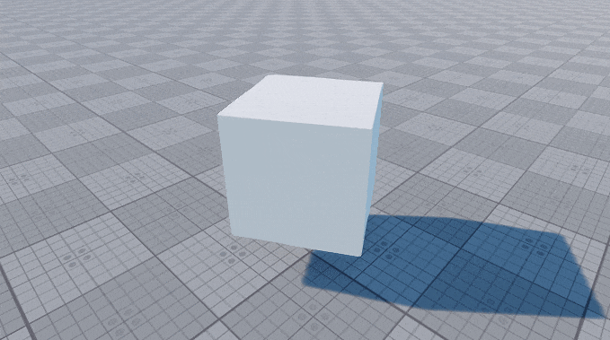

  8. Check the result.

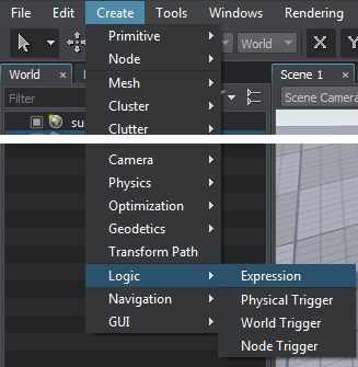

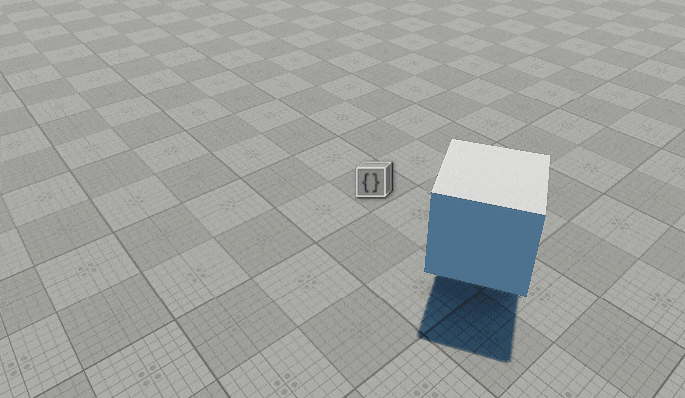

  1. In the Menu Bar, choose Create -> Logic -> Expression to create the WorldExpression object.
  2. Place the World Expression box somewhere in the world. The added World Expression node will appear in the World Hierarchy.

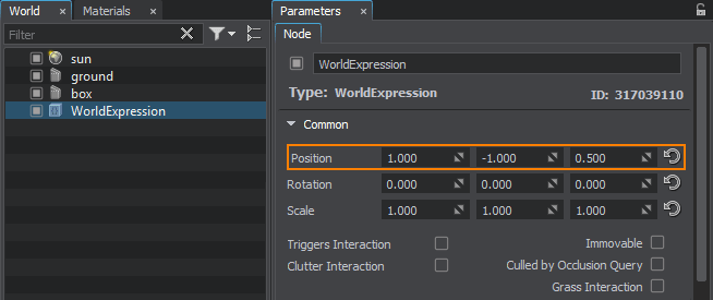

  3. Choose the added WorldExpression node in the World Hierarchy window and go to the Node tab of the Parameters window. Here change the position to 1.0, -1.0, 0.5.
    Now you have the primitive box and the World Expression object on a plane.

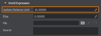

  4. Specify the Update Distance Limit for the WorldExpression node - it is the maximum distance from the camera up to which the expression shall be executed. Let's set it to 10 units.
  5. Choose the WorldExpression node in the World Hierarchy and go to the World Expression section of the Parameters window.
  6. Put the following code into the Source field.

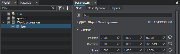

  7. Make the box node a child of the WorldExpression node by dragging it in the World Hierarchy.
    Now the box node is the child of the WorldExpression node. It means that the box object inherits all expression transformations of the World Expression object.
    All the child nodes of the WorldExpression node inherit expression transformations.
    Our expression shall be executed (i.e. the transformation shall be updated according to the script) as long as the distance from the camera to the WorldExpression node does not exceed the specified Update Distance Limit)
If you reset the position of the box node to its parent position, you will get the same result as in the Method 1.
