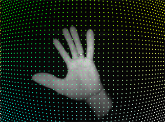

Sensor Images#
Along with the computed tracking data, you can get the raw sensor images from the Leap Motion cameras.
A raw sensor image with superimposed calibration points
The image data contains the measured IR brightness values and the calibration data required to correct for the complex lens distortion. You can use the sensor images for augmented reality applications, especially when the Leap Motion hardware is mounted to a VR headset.

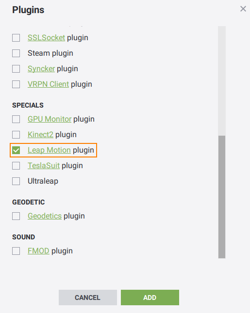

  1. Download the Leap Motion SDK and install Leap Motion device drivers.
  2. Create a new project with LeapMotion support via UNIGINE SDK Browser: click Plugins, check the LeapMotion support (LeapMotion plugin) option in the form that opens and click OK.
    LeapMotion Plugin on Plugins Panel
    To add LeapMotion support to the existing project, in UNIGINE SDK Browser, click Other Actions -> Configure Project -> Plugins -> LeapMotion support (LeapMotion plugin) -> OK.
