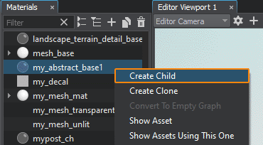

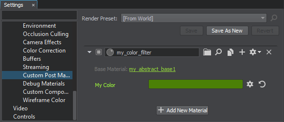

2. Inheriting a Base Material from the Abstract One#
Now we are going to inherit a base material from the created abstract one (my_abstract.abstmat) to extend its functionality.
To begin with, we'll implement a simple color filter post-effect.
Create a new file with the *.basemat extension. Again, the file name is used as the base material name.
Describe the base material specify that it has the abstract material my_abstract as a parent:
ULON
BaseMaterial <parent=my_abstract>
	// Add the color parameter that will define the optical filter color
	Color my_color = [0.5 0.5 0.5 1]
	// All shader variables that are defined in the material should have a prefix to be referred to in shaders
	// For sliders, colors, and other basic parameters, it is defined with var_prefix currently set as 'var'
	// For textures, it is texture_prefix currently set as 'tex'
	Shader fragment=

In order to test our first post-effect do the following:
  • Find the my_abstract_base1.basemat in the Materials window, right-click it, choose Create Child, and rename your new material as my_color_filter.
  • As it is a post-effect, to apply the material globally we should open the Settings -> Render -> Custom Post Materials
  • Click Add New Material and specify the my_color_filter material. After shis you can change the filter color.

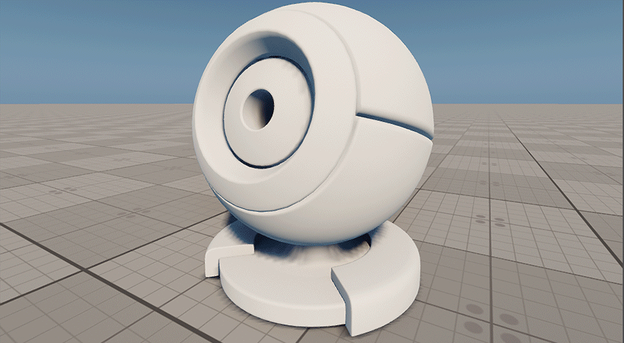

Here is the final image with our first post-material applied.
Repeat the steps above for the my_abstract_base2.basemat base material to test the second post-effect. Here is what it may look like:
