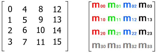

In simple terms, a matrix in 3D graphics is an array of numbers arranged in rows and columns:

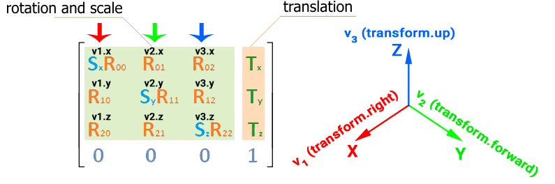

Usually, 4x4 matrices are used. Such size (4x4) of matrices is caused by the translation state in 3D space. When you put a new node into the world, it has a 4x4 world transform matrix that defines the position of the node in the world.
In UNIGINE, matrices are column major (column-oriented). Hence, the first column of the transform matrix represents the X vector of the local coordinate system (v1), the second represents the Y vector (v2), the third represents the Z vector (v3), and the fourth represent the translation vector t. First three columns show directions of local coordinate axes (rotation) and the scale of the origin. The last column contains the translation of the local origin relatively to the world origin.

Translation#
The last column of the transform matrix shows the position of the local origin in the world relatively to the world origin. The next matrix shows the translation of the origin. The translation vector t is (3, 0, 2).
Scaling#
The length of the vector shows the scale coefficient along the axis.

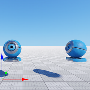

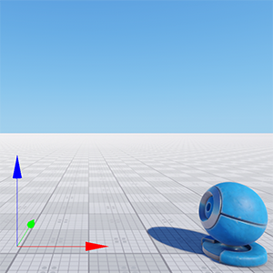

The result will be different. The pictures below show the difference (camera is located at the same place).
Order: rotation and translation
Order: translation and rotation
The pictures above show the position of the meshes related to the world origin.

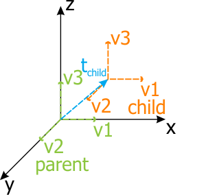

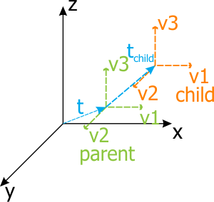

Matrix Hierarchy#
One more important concept is the matrix hierarchy. When a node is added into the world as a child of another node, it has a transformation matrix that is related to the parent node. That is why the Node class distinguishes between the functions getTransform(), setTransform() and getWorldTransform(), setWorldTransform(), which return the local and the world transformation matrices respectively.
If the added node has no parent, this node uses the World transformation matrix.
What is the reason of using a matrix hierarchy? To move a node relative to another node. And when you move a parent node, child nodes will also be moved.
Parent origin is the same with the world origin
Parent origin has been moved and the child origin has also been moved
Pictures above show the main point of the matrix hierarchy. When the parent origin (node) is moved, the child origin will also be moved and the local transformation matrix of the child would not be changed. But the world transformation matrix of the child will be changed. If you need the world transformation matrix of the child related to the world origin, you should use the getWorldTransform(), setWorldTransform() functions; in case, when you need the local transformation matrix of the child related to the parent, you should use the getTransform(), setTransform() functions.

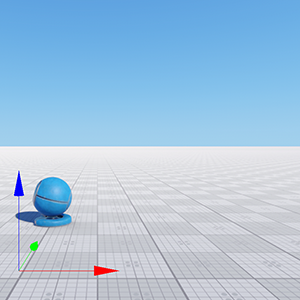

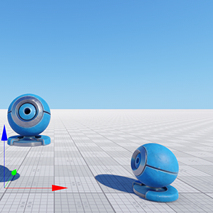

If you comment the following line:
// make the one node the child of another
material_ball_parent->addChild(material_ball_child);
you get a different result:
Parent-child nodes
Nodes are independent
When nodes are independent, they have different local and world transformation matrices. In case of parent-child nodes, the child's local transformation matrix remains the same after moving, but the world transformation matrix is changed (you can check that by using the debug profiler).
