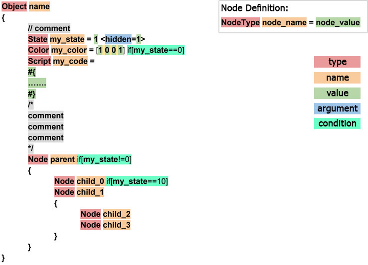

ULON Description Example

The basic element (building brick) of ULON is called a node. Each node has a type, a name, and a value.
The following construct is used to declare a node:
ULON Node Declaration
Both node name and type are written as strings:
  • either a quoted string with standard escape characters,
  • or a bare word, beginning with a lower case letter, containing only letters, digits, and underscores "_".
Here is an example:
Source code
"Node Type" "node name" = node_value
NodeType node_name1 = node_value
Node declarations can be nested, thus forming a hierarchy. So a node can have a parent and an unlimited number children.
Source code
Node parent
	Node child_0
	Node child_1
		Node child_2
		Node child_3
