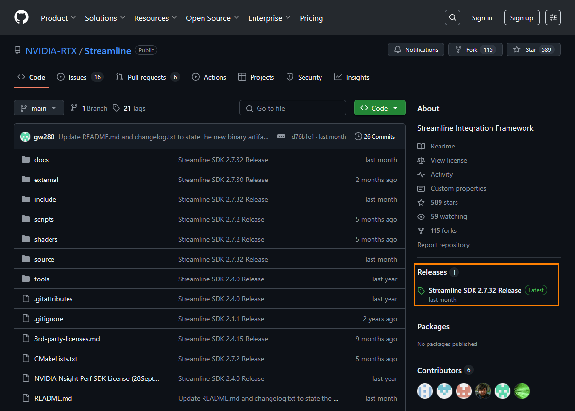

  4. Switch to the repository homepage by clicking Streamline as you did previously.
  5. Download Streamline SDK 2.7.32 Release. Click on the Releases link:

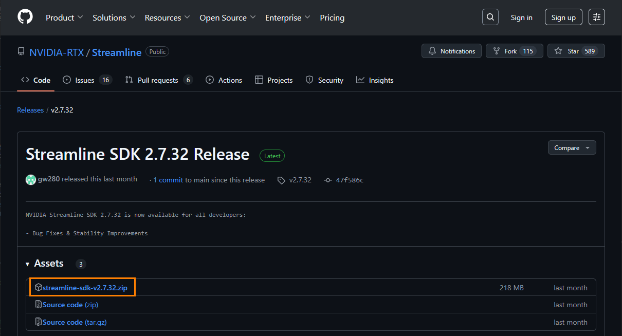

    Find Streamline SDK 2.7.32 Release and download the archive:
  6. Extract the ZIP archive. By default, it is extracted to the streamline-sdk-v2.7.32 folder. However, you can rename it if necessary.
