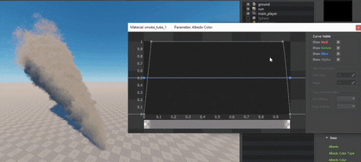

To open Curve Editor, click on the curve preview widget.
A separate Curve Editor window opens for each parameter. The previously opened windows are not closed.

The horizontal axis represents the input value, such as life time. The values are normalized and depend on the corresponding value of the node (for example Life Time).
The vertical axis represents the range of available parameter values. The scale is controlled by Max Value.
The curve view can be zoomed in and out along both axes by using the scroll wheel, or along either axis individually by using the corresponding display parameter.
The curve view can be panned by dragging mouse while holding the middle button pressed or holding the Ctrl button and using the cursor keys.
If a parameter is adjusted via multiple curves, you can hide some of them via the corresponding checkboxes with color coding.
