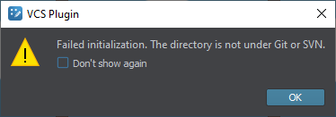

  4. Ensure the version control system (SVN, Git) manages your project. Otherwise, an error message will appear when launching UnigineEditor.

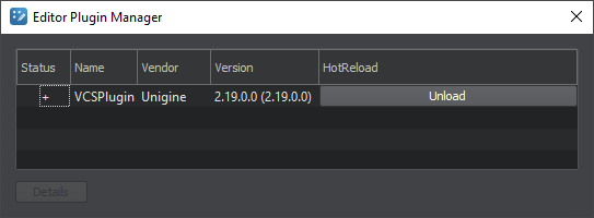

VCSIntegration Plugin can be disabled the same way as other plugins in the Editor:
  1. Select Windows -> Editor Plugin Manager in the Menu Bar.
  2. Find VCSIntegration Plugin in the list and click Unload.
After that, the plugin will be disabled until the Editor is restarted or the Load button is clicked.
