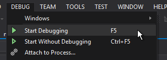

  3. Click the button on the toolbar (or DEBUG -> Start Debugging) to start the project.

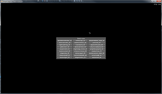

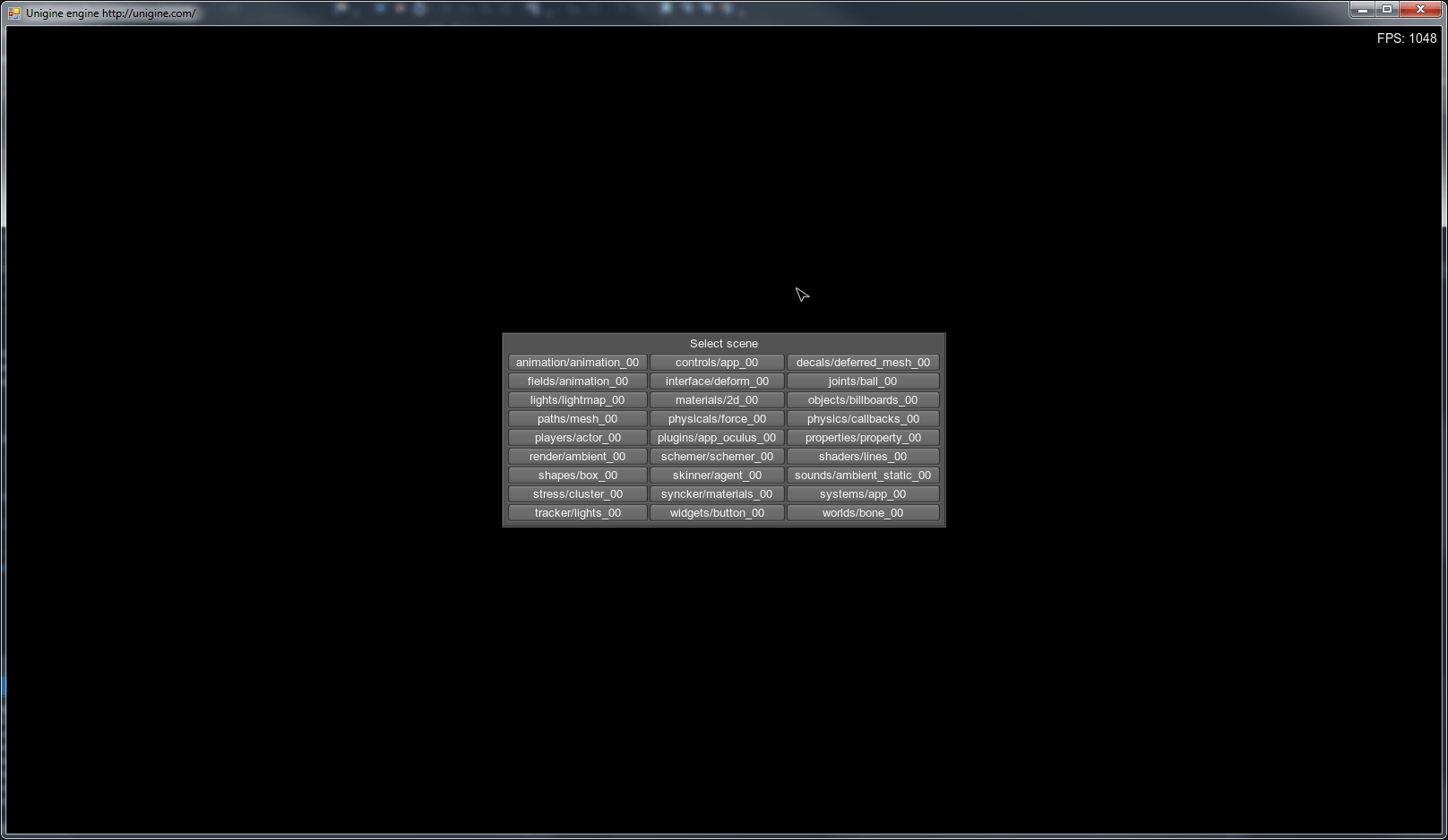

    Windows Form Application will open.
