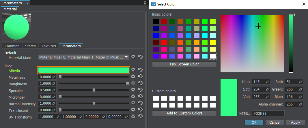

  5. Create 3 new materials in the UnigineEditor by choosing Create->Create Material in the Asset Browser. Make them children of the mesh_base material and give them names as specified in the previous code snippet (mesh_base_*).
  6. Select materials one by one in the Materials window and in the Parameters window switch to the Parameters tab and click on the color field near Albedo to choose different colors for the objects via the color picker.
