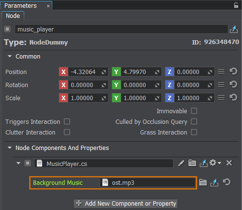

- Create a new Dummy Node, rename it to "music_player", and place it somewhere in the world.
- Add the MusicPlayer component to the music_player node.
- Assign the imported music asset (programming_quick_start/music/ost.mp3) to the Background Music field of the MusicPlayer component.
