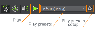

The Run button is available in the Editor to run an instance of the application in a separate window. Along with the button, there are settings available to fine-tune run options.
That's how we'll make the wheel rotate using C# Component System and run an instance to immediately check it:
