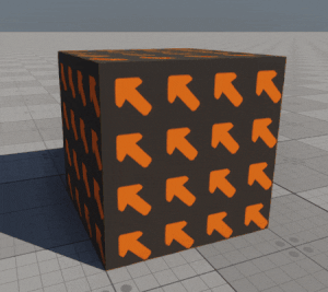

Time Node
This node outputs a float value of time in seconds since the moment of the application startup.
This node has parameters (see below) that define its behavior, to view and change them double-click somewhere inside the node.
