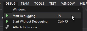

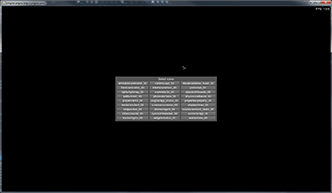

  3. Click the button on the toolbar (or DEBUG -> Start Debugging) to start the project.
    Windows Form Application will open.

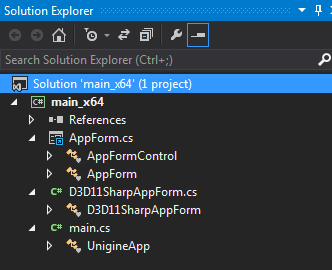

This sample contains 4 classes:
  • AppForm — inherits the Unigine.App class. In this class thedoUpdate(), doRender() anddoSwap() functions are overridden and call the update(), render() andswap() functions respectively.
  • AppFormControl — inherits the System.Windows.Forms.Form class. This class implements all the necessary events, which will be performed when user interacts with the application.
  • D3D11SharpAppForm — inherits the AppForm class and initializes the graphics Direct3D11 API in the Windows Forms Application via the SharpDX library.
  • UnigineApp — defines the entry point of the program. C# Wrapper and Engine are initialized here.
AppForm, AppFormControl, D3D11SharpAppForm are defined in the Unigine namespace.
