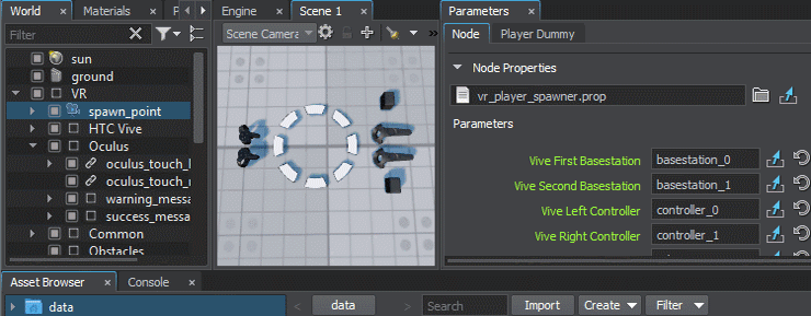

4. Attaching Objects to HMD#
Sometimes it might be necessary to attach some object to the HMD to follow it (e.g. a hat). All movable objects (having the movable.prop property assigned and the Dynamic flag enabled) have a switch enabling this option.
For example, if you want to make a cylinder on the table attachable to the HMD, just select the corresponding node named "cylinder" in the World Hierarchy click Edit in the Reference section and enable the Can Attach to Head option.
Then select the parent node reference, and click Apply.

7. Attaching Objects to Controllers#
If you need to attach some object loaded in run-time to a controller (e.g., a menu), you can assign the AttachToHand property to this object.
For example, if you have a GUI object and want to attach it to the controller, select this object in the World Hierarchy, click Add New Property in the Parameters window, and specify the AttachToHand property.
The property settings allow specifying the controller to which the object should be attached (either left or right), as well as the object's transformation.
In the VR Sample, this component is attached to the hand_menu node and initializes widgets in run-time.
