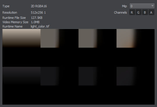

Light Color#
A 2D texture defining the color of the LightWorld for different times of day. The texture means the following:
  • Top to down: the LightWorld's angle of slope.
The texture has two parts for the Sun (the upper part) and the Moon (the lower part) scattering modes. Left to right texture direction doesn't matter, so you can use the texture 1×512 (width to height) pixels in size.
Light Color LUT Texture
Sampling the Light Color LUT texture based on the sun angle. A black texture is used for the Base and Mie LUTs for clarity.
