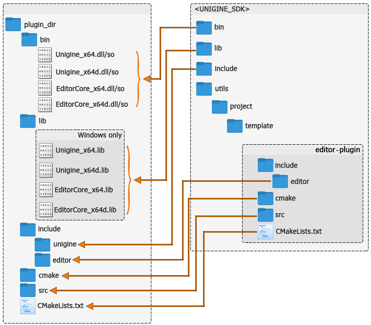

Using Plugin Template#
To start developing your plugin for UnigineEditor perform the following actions:
  1. Check the Editor Plugin Template option when creating a new project in SDK Browser (or choose Other Actions -> Configure Project if you want to use your new Editor plugin in an existing project).
    Adding a plugin template
  2. Click Create New Project (or Update Configuration if you're adding a template to an existing project).
After clicking the Create New Project / Update Configuration button, a set of projects for the Editor plugins will be added to your UNIGINE project's source folder and all necessary files will be added to these folders depending on your operating system and API + IDE selection in project settings:
  • Windows OS: C++ (Qt-based / CMake) or UnigineScriptCMake will be used to build your plugin.
  • Windows OS: C# (.NET) or C++ (Visual Studio) — a .vcxproj project will be created and Visual Studio 2022 will be used to build your plugin.
  • LinuxCMake will be used to build your plugin regardless of project configuration.
You can open this project in your IDE, build it, and give it a test drive right in the Editor as the project is pre-configured to launch with the UnigineEditor.
