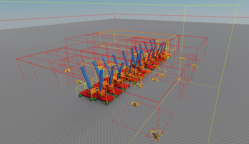

Use the world_show_spatial console command to enable spatial tree visualization.
Spatial tree visualization
