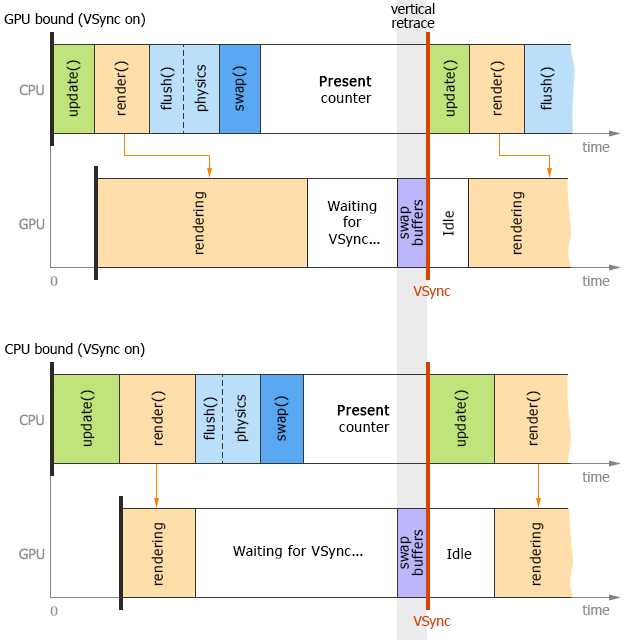

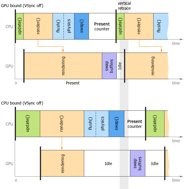

The 4 schemes below demonstrate the following:
  • The first 2 schemes show calculation and rendering of the frame when VSync is disabled (in both cases the monitor vertical retrace is ignored):
    • On the 1st scheme, the CPU calculates the frame faster than the GPU can render it. So, the CPU waits for the GPU (the Present time is high).
    • On the 2nd scheme, the CPU calculations are performed slower than the GPU renders the frame. So, the GPU has to wait while the CPU finishes its calculations. In this case, the Present time will be small.

  • Schemes 3 and 4 show calculation and rendering of the frame when VSync is enabled (the monitor vertical retrace is taken into account):
    • On the 3rd scheme, the CPU calculates the frame faster than the GPU can render it and the CPU waits for the GPU. However, in this case, both the CPU and the GPU also wait for VSync.
    • On the 4th scheme, the CPU calculates the frame slower than the GPU renders it. In this case, the GPU waits not only the CPU finishes its calculations, but also VSync.
Single-threaded mode
