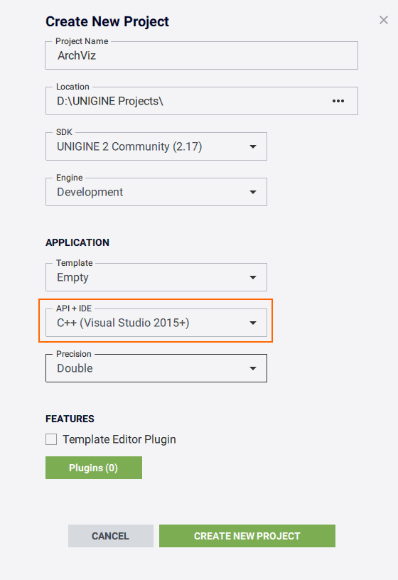

  • Create a new empty C++ project. Open the SDK Browser, go to the My Projects tab, and click the Create New button.
  • In the window that opens, be sure to select C++ (Visual Studio 2015+) from the API + IDE list and click Create New Project.
  • Once the new project is created, it will appear on the My Projects tab. Click Open Editor under the created project to open it in UnigineEditor.
