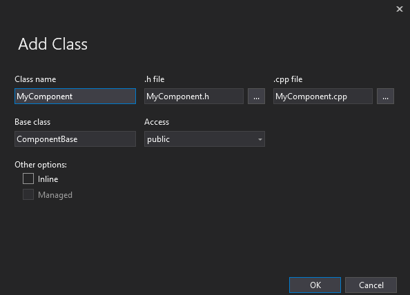

2. Add New C++ Component Class
2. 添加新的C++组件类#
In an IDE create a new C++ class (Project → Add Class) and call it MyComponent.在IDE中创建一个新的C++类(Project → Add Class)并将其命名为MyComponent
Make sure it inherits from the ComponentBase class. You can build a whole hierarchy using your own components, by inheriting some components from others in accordance with the OOP principles (we'll review this in detail later).确保它继承自ComponentBase类。你可以根据OOP原则(我们稍后会详细讨论),通过让某些组件继承其他组件来构建完整的层次结构。
Two files*.h and *.cpp will be added to your C++ project.将会向你的C++项目添加两个文件(*.h*.cpp)。

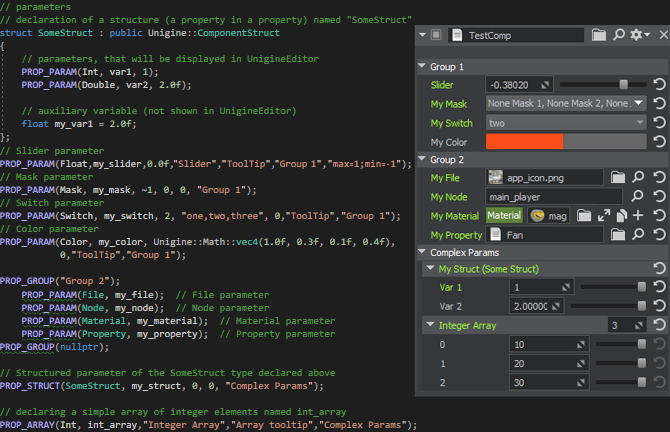

  2. Declare parameters with their default values (if any). The simplest way to declare a parameter is to use the following macro (optional arguments are enclosed in square brackets []):声明参数及其默认值(如果有)。声明参数的最简单方法是使用以下宏(可选参数用方括号[]括起来):
    源代码 (C++)
    PROP_PARAM(param_type, name[, default_value, title, tooltip, group]);
    A set of macros enables you to define multiple types of component parameters to be displayed and adjusted in UnigineEditor. See the the ComponentBase class documentation for the detailed information about supported parameter types and attributes.通过一组宏定义,你可以在UnigineEditor中配置多种组件参数类型并进行调整。完整支持的参数类型及属性说明,请参阅ComponentBase类的官方文档。
    参数类型清单
    The list of available macros includes the following ones to declare complex-type parameters (arrays, structures, and arrays of structures):以下宏可用于声明复合类型参数(数组、结构体及结构体数组):
    源代码 (C++)
    PROP_STRUCT(type, name);
    PROP_ARRAY(type, name);
    PROP_ARRAY_STRUCT(type, name);

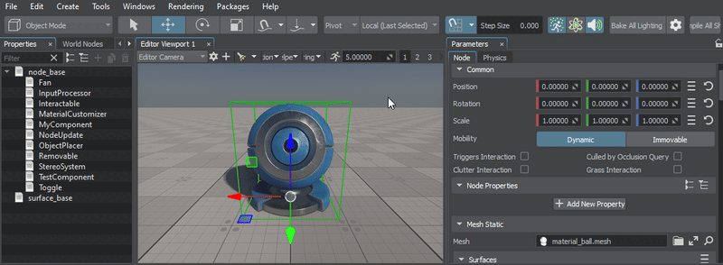

5. Assign Component To Nodes In Editor
5. 在编辑器中为节点分配组件#
After successful registration all available properties associated with your C++ components are displayed in the Properties window as children of the basic node_base property.成功注册后,所有可用C++组件属性将作为node_base属性的子项显示在Properties(属性)窗口中。
The component is ready, but now it must be assigned to some node, otherwise its code won't be executed. Decide which object you want to rotate (e.g. Material Ball), drag the property (MyComponent.cpp) from the Properties hierarchy and drop onto this object (you can drop it on the object directly in the viewport or on the node in the World Nodes window).组件已就绪,但现在必须将其分配给某个节点,否则其代码不会被执行。选择需要旋转的对象(如Material Ball),将属性文件(MyComponent.cpp)从Properties(属性)层级拖放至目标对象(可直接拖到视口对象或World Nodes(世界节点)窗口中的节点上)。
In the Parameters window set the desired Angle value with a slider and save the world by hitting Ctrl + S.在参数窗口中使用滑块设置角度值(Angle),按Ctrl + S保存场景。

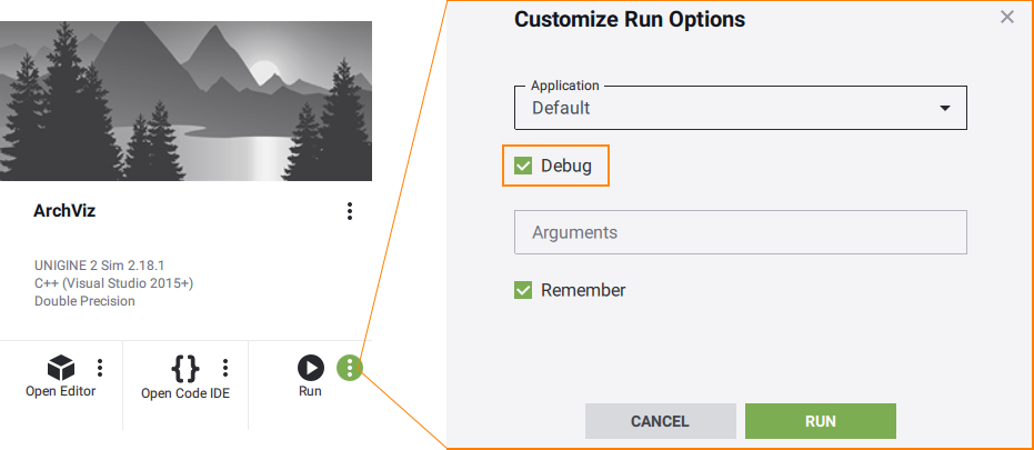

Now, we're ready to launch our application via the SDK Browser by selecting the project on the Projects tab and clicking Run. But before doing so let's make sure, that appropriate Customize Run Options (Debug version in our case) are selected, by clicking an ellipsis under the Run button (check Debug and Remember then click Run).现在,我们已准备通过SDK Browser运行应用:在"Projects"(项目)选项卡选中项目后点击Run("运行"。但在此之前,请点击运行按钮下方的省略号图标,确保已选择正确的"Customize Run Options"(自定义运行选项)(本例选择Debug版本),勾选"Debug"并"Remember"(记住)设置后点击"Run"(运行)。

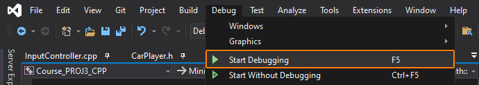

To compile all your components, build the application, and debug it by running it directly from the IDE, select Debug → Start Debugging (or press F5):要编译所有组件、构建应用程序并直接从IDE运行调试,请选择Debug → Start Debugging(调试 → 开始调试)(或按F5键):
Now you can add the necessary breakpoints and just press F5 to start the debugging process.现在你可以添加必要的断点,只需按F5即可开始调试过程。

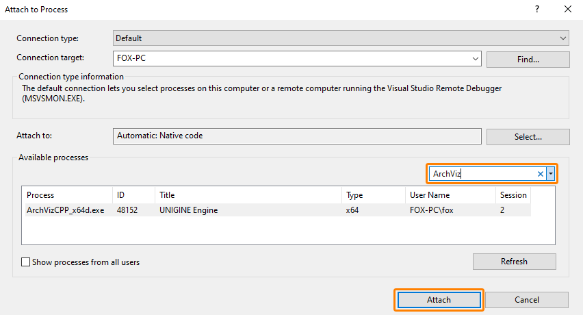

You can also connect Visual Studio debugger to an instance of your application that is already running. The most common case is launching it via the SDK Browser. Just add necessary breakpoints and select Debug → Attach To Process from the main menu.你也可以将Visual Studio调试器连接到已运行的应用程序实例。最常见的情况是通过SDK Browser启动应用程序。只需添加必要的断点,然后从主菜单中选择Debug → Attach To Process(调试 → 附加到进程)。
Type your project's name in the search field in the Available processes section to find the process you need. Select it in the list and click Attach在"Available processes"(可用进程)部分的搜索栏中输入项目名称以查找所需进程。从列表中选择该进程,然后单击Attach(附加)。

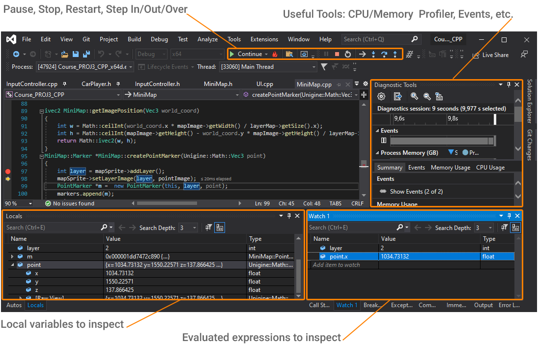

Breakpoints are used to pause your application by stopping execution of your code and giving you a chance to inspect and analyze your program's operation. You can check values of variables, and move step-by-step through your code.断点用于通过停止代码执行来暂停应用程序,让你有机会检查和分析程序运行情况。你可以检查变量的值,并逐步执行代码。

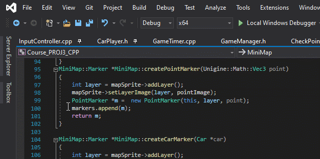

To set up a breakpoint put the cursor to the desired line of your code and press F9 or use the menu.设置断点时,将光标置于目标代码行后按F9键或使用右键菜单操作。
