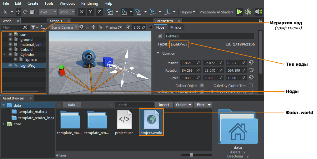

在UnigineEditor中查看世界及其节点
Viewing the world and its nodes in UnigineEditor在UnigineEditor中查看世界及其节点

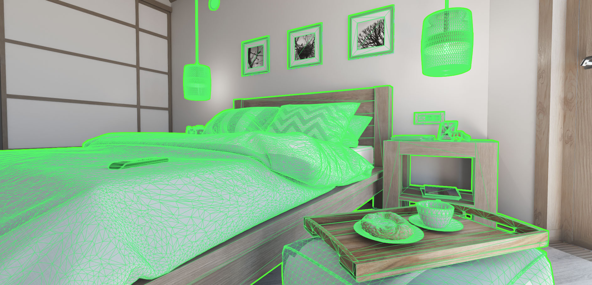

Mesh Objects (Static, Skinned, and Dynamic)
网格对象(静态、蒙皮和动态)#
Static Mesh is an object consisting of polygons that define its geometry. This geometry is stored in the *.mesh file and is always unchanged. Usually Static Mesh is used to create static geometry, such as buildings or furniture. The geometry of such objects is created in third-party 3D editors and then imported into the engine. In addition to Static Mesh, there are two other similar objects used in specific cases:静态网格(Static Mesh)是由定义其几何形状的多边形构成的对象。这种几何形状存储在*.mesh文件中且始终不变。静态网格通常用于创建静态几何体,如建筑物或家具。这类对象的几何体在第三方3D编辑器中创建,然后导入引擎。除静态网格外,还有两种用于特定情况的类似对象:
  • Dynamic Mesh is an object the geometry of which can be modified procedurally. As a rule, such modification is required to change the object shape as a result of some external impact (clash, explosion) or to create dynamically changing surfaces (fabric, wire, liquid, etc.).动态网格(Dynamic Mesh)是其几何形状可以通过程序修改的对象。通常,这种修改是为了因应某些外部影响(碰撞、爆炸)而改变物体形状,或创建动态变化的表面(织物、电线、液体等)。

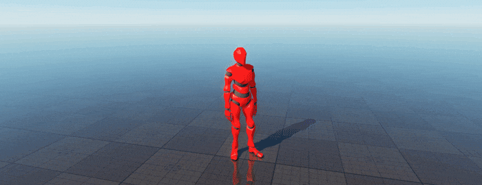

  • Skinned Mesh is an object used to create characters with skeletal animation or animation based on a set of distorted versions of an object (morph targets or blend shapes). In addition to geometry, it contains animation data.蒙皮网格(Skinned Mesh)是用于创建带有骨骼动画或基于一组变形版本对象(变形目标或混合形状)动画的角色对象。除了几何体外,它还包含动画数据。

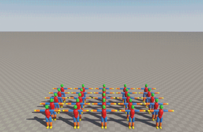

  • Mesh Cluster is an object that can contain a great number of identical meshes placed around the scene as you see fit. Mesh Cluster manages these meshes as one object, but their position, rotation, and scale can be changed manually. This object is usually used to place multiple identical objects, for example, houses in a neighborhood. Identical mesh objects can be baked to Mesh Cluster manually or in semi-automatic mode.网格簇(Mesh Cluster)是可以包含大量相同网格的对象,这些网格可以按照你的需求放置在场景各处。网格簇将这些网格作为一个对象来管理,但它们的位置、旋转和缩放可以手动更改。该对象通常用于放置多个相同物体,例如社区中的房屋。相同的网格对象可以手动或半自动模式烘焙到网格簇中。

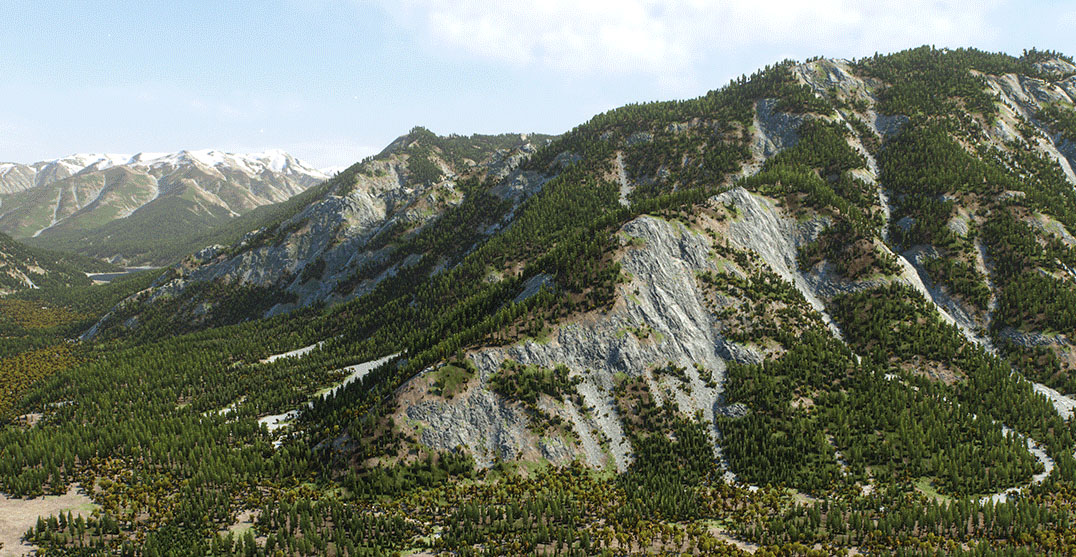

UNIGINE has Landscape Terrain, which is used to create a virtually infinite arbitrary landscape with high level of detail, optimized performance, and flexible settings. It supports collaborative editing and the ability to modify the surface in real time (creating craters, explosion funnels, and trenches). The Landscape Terrain object consists of individual layers (Landscape Layer Map), each storing the data used for rendering (elevation, imagery, and masks). These layers are blended to create a realistic landscape. You can draw a landscape from scratch in the Editor or use data generated in a third-party application.UNIGINE拥有景观地形(Landscape Terrain)功能,可用于创建具有高细节度、优化性能和灵活设置的近乎无限的任意地形景观。它支持协作编辑和实时修改地表的能力(如创建弹坑、爆炸漏斗和战壕)。景观地形对象由独立的图层(Landscape Layer Map)组成,每个图层存储用于渲染的数据(高程、影像和遮罩)。这些图层通过混合来创建逼真的地形景观。你可以在编辑器中从头绘制地形,或使用第三方应用程序生成的数据。
You can also use the Terrain Global object to create a landscape — it has specific features and is mainly used for flight simulators. We are not going to review this object in the course.你也可以使用全局地形(Terrain Global)对象来创建地形,它具有特定功能,主要用于飞行模拟器。本课程将不涉及该对象的详细介绍。

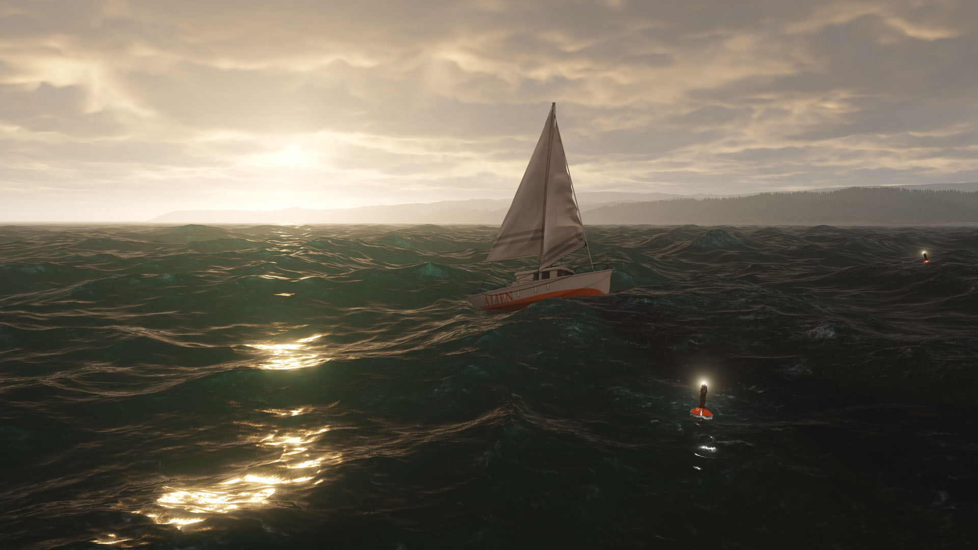

Water
水体(Water)#
Water
To create realistic water (with waves, ripples and foam, reflection and refraction effects) and various liquids, UNIGINE provides two objects:为创建逼真的水体(含波浪、涟漪和泡沫,反射和折射效果)和各种液体,UNIGINE提供两种对象:
  • Global Water is an infinite mesh with automatic tessellation used to create the global ocean. This object has an underwater mode, and the water level is the same everywhere. You can create realistic waves on the surface by setting the Beauforts mode or using the Layers mode. The object does not interact with physical objects as this would require a large amount of calculations. 全局水体(Global Water)是带有自动细分功能的无限网格,用于创建全球海洋。该对象具有水下模式,且各处水位高度一致。你可以通过设置蒲福风级模式(Beauforts mode)或使用图层模式(Layers mode)在表面创建逼真波浪。该对象不与物理对象互动,因为这需要大量计算。
  • Water Mesh is used for finite basins (pools, ponds, lakes, etc.), as well as for modeling any liquids in a confined basin of arbitrary shape. It can be used to create a mountain lake or a stream of water with an altitude difference above sea level. This object supports interaction with physical bodies (buoyancy simulation) but has no underwater mode. You can create ripples and waves on the surface using the Normal map or a combination of four directional geometric waves.水体网格(Water Mesh)用于有限水域(水池、池塘、湖泊等),以及模拟任意形状封闭容器中的任何液体。它可用于创建高山湖泊或具有海拔落差的溪流。该对象支持与物理体的交互(浮力模拟)但不具备水下模式。你可以使用法线贴图或四种方向性几何波的组合在表面创建涟漪和波浪。

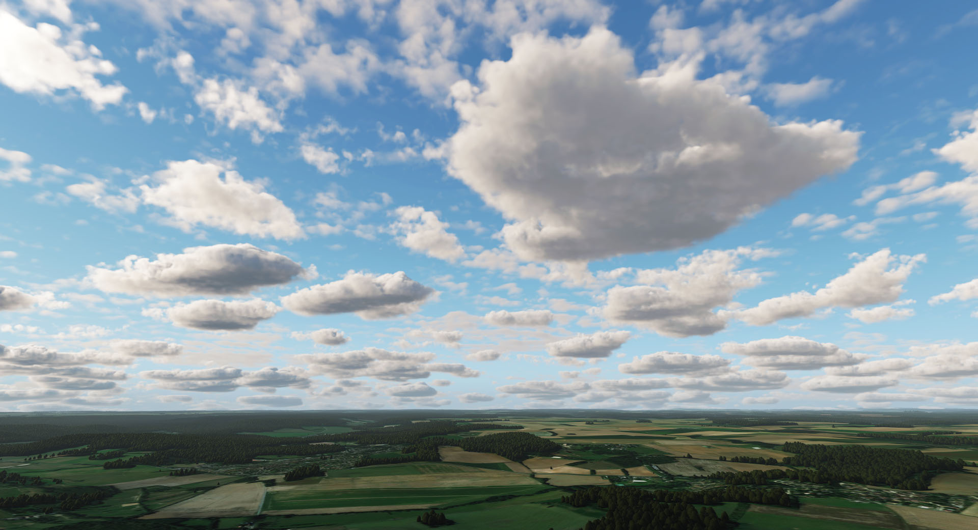

Cloud Layer
云层(Cloud Layer)#
Cloud Layer
This object allows generating layers of volumetric clouds that drift across the sky, with realistic lighting, shadow casting, and interactivity.该对象可生成体积云层,这些云层会随天空漂移,具有逼真的光照、投影和交互效果。
It supports the 10 basic types of clouds that exist in nature (cumulus, cirrus, etc.), which are available as customizable presets, and you can simultaneously add several different layers at different heights. Support for the Earth's curvature is also available to make the cloudy sky conform to the planet's shape.它支持自然界存在的10种基本云类型(积云、卷云等),这些类型可作为可定制预设使用,并且你可以同时在多个不同高度添加不同云层。还支持地球曲率效果,使云空符合行星形状。

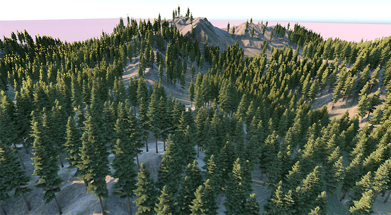

Grass
植被(Grass)#
Grass
This object is used to create animated vegetation, including grass. Its appearance is determined mainly by two textures: the Diffuse texture, which defines variations of each type of vegetation, and the Mask texture, which defines the areas of growing and density.该对象用于创建含动画效果的植被,包括草类。其外观主要由两种纹理决定:定义每种植被变体的漫反射(Diffuse)纹理,以及定义生长区域和密度的遮罩(Mask)纹理。
Vegetation diversity is also achieved through a probability factor that affects height, color, slope, rotation, and other parameters.植被多样性还通过影响高度、颜色、坡度、旋转等参数的概率因子来实现。

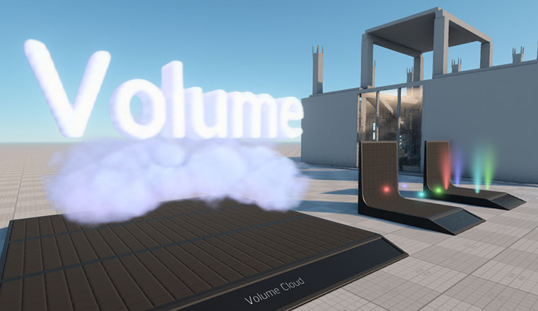

  • Volumetric objects are used to create volumetric effects (fog, clouds, sun rays, etc.):体积对象(Volumetric objects)用于创建体积特效(雾、云、阳光射线等):
    • Volume Box creates a volumetric effect of rectangular shape: fog, clouds, rays of light from the sun.体积盒(Volume Box)创建矩形体积特效:雾、云、太阳光线。
    • Volume Sphere creates a spherical or ellipsoidal volumetric effect such as fog, haze, or glow around point light sources (candles, lamps, etc.).体积球(Volume Sphere)创建球形或椭球形体积特效,如点光源(蜡烛、灯具等)周围的雾、薄雾或辉光。
    • Volume Omni creates a visible volume of light emitted from a flat surface (e.g. flat wall and ceiling lamps).全向体积(Volume Omni)创建从平面表面(如平板壁灯和吸顶灯)发射的可见光体积。
    • Volume Projected creates light rays from directional light sources (car headlights, spotlights).投影体积(Volume Projected)创建定向光源(汽车前灯、聚光灯)的光线效果。

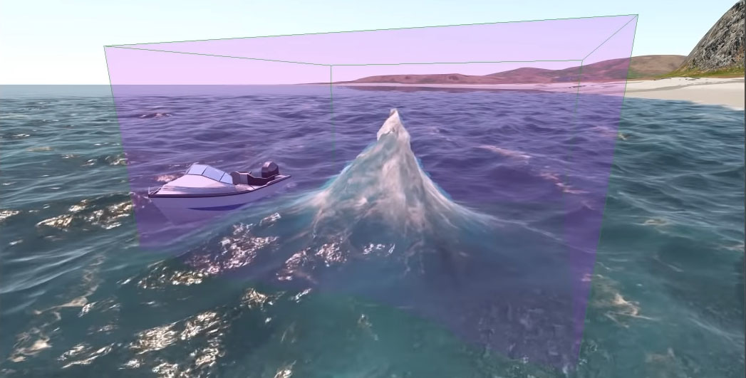

    • Field Height defines areas of Global Water where the water level should change due to external effects (e.g. to create a wake or water disturbance near certain objects).高度场(Field Height)定义全局水体(Global Water)中因外部效应(如在某些物体附近创建尾流或水体扰动)需要改变水位的区域。

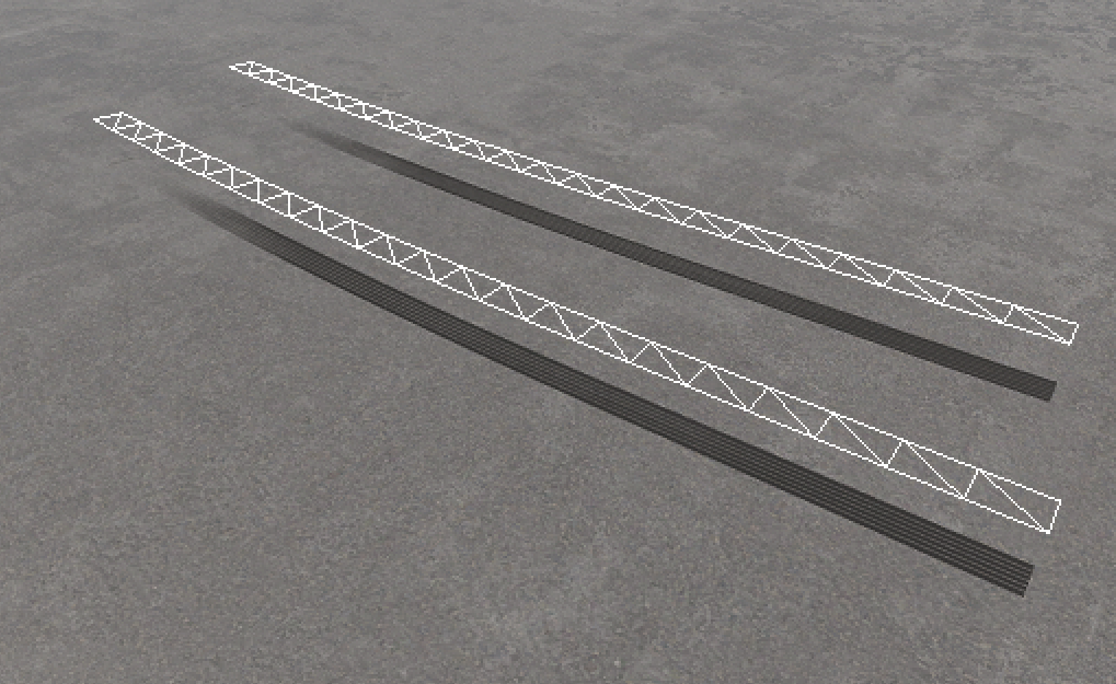

贴花(Decal)#
Decal

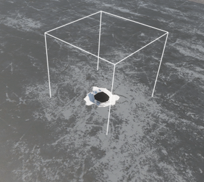

Decal is a material projection on the surface. Decals allow adding details — they help imitating holes, stains, traces, puddles, etc. Decals can also be projected onto the water surface and used to create holes in the landscape.贴花(Decal)是投射在表面的材质。贴花可用于添加细节:帮助模拟孔洞、污渍、痕迹、水洼等效果。贴花还能投射到水面,并用于在地形上创建孔洞。
There are three types of decals in UNIGINE:UNIGINE中有三种贴花类型:
  • Orthographic Decal is a decal projected onto a surface using orthogonal projection. Its size is independent of the distance to the surface on which it is projected. This decal follows the shape of any surface, so it looks realistic.正交贴花(Orthographic Decal):使用正交投影投射到表面的贴花。其大小与投射表面的距离无关。这类贴花会贴合任何表面形状,因此看起来十分逼真。
  • Projected Decal is a decal projected onto a surface using perspective projection. The decal size increases as the distance to the surface increases. Projected Decal forms a projection pyramid, the size of which can be adjusted using the settings.透视贴花(Projected Decal):使用透视投影投射到表面的贴花。贴花大小会随投射距离增加而增大。透视贴花形成可调节大小的投射棱锥。.
  • Mesh Decal is a decal that projects arbitrary geometry onto the surface using orthogonal projection. This type of decal is suitable for creating large objects with complex shapes (e.g. an entire airfield).网格贴花(Mesh Decal):使用正交投影将任意几何体投射到表面的贴花。适合创建具有复杂形状的大型物体(如整个机场)。
