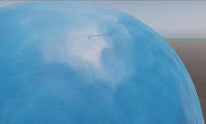

Let's take an object that already has a normal map applied and add another one to introduce additional surface details. Directly combining two normal maps without reorienting their vectors might lead to incorrect shading, or an unnatural lighting response.

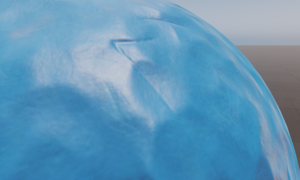

To avoid this, use the Reorient Normal Blend node, which ensures the additional normal map correctly conforms to the base normal, preserving accurate shading and surface details.

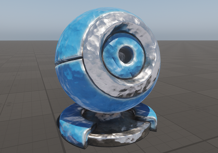

Original normal map Two maps
(Add node)
Two maps
(Reorient Normal Blend node)
